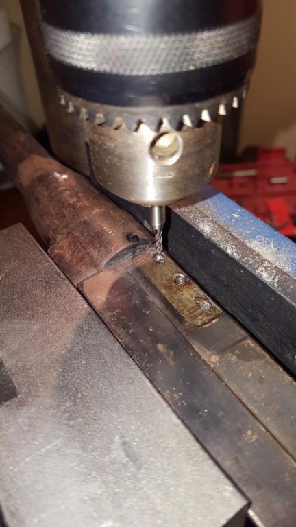

About the remaining screws
If you have a dremmel with a fine round diamond head
You can line up the punch mark and dril straight
jsne

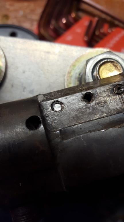

Got a chance to clamp the action in the drill press today and touch up the studs with an endmill.
https://www.milsurps.com/images/impo...snkam1b0-1.jpghttps://www.milsurps.com/images/impo...kebyjmjy-1.jpg
Should be able to get a center off this.
Even if you take most of it out like that and then heat and worm it out...
You are making a mountain out of a molehill here.......... We had these screws shear all of the time as well as most(?) other screws on most other equipment we had in service. Every old car owner too has encountered them all the time too. Centre drill, drill through - at least it's not a blind hole - heat up and screw (or worm) out. It really is THAT simple!
Just making sure I don't enter the ranks of bubba!!
