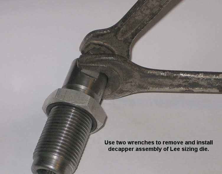

Technically, the Lee full-length sizer die doesn't have a mandrel. I does have an expander/decapper rod. Trick to keep the rod from pulling out is to tighten its collet ("clamp nut") very tight using two stout wrenches and a lot of muscle. Degreasing the rod and the hole in the collet can help, as can roughening the portion of the rod that fits inside the collet.
https://www.milsurps.com/images/impo...9/4ptt2w-1.jpg
Here's advice from Lee's website -
Remove / Replace Decapping Rod
Posted on 19 January 2017 11:00 AM
To loosen the Decapper Clamp, you will need a 1/2" Box Wrench on the Clamp Nut and a 3/4" Open End Wrench on the die body. Loosen the Decapper Clamp until the Decapper is free to move. The Pin and/or Clamp should be cleaned and left to dry. The end of the Decapper Rod is to be flush with the top of the Decapper Clamp. The trick is to hold the Pin flush to the top and at the same time tighten the Clamp. Once you have the Pin aligned flush, tighten the Clamp in the die using both wrenches. Now tighten it again. It needs to be TIGHT. The pin may move back a short distance with the first case you deprime, but it should stay in that position now. You know it is tight enough when the primer pops out, the Pin did not move and the case pulls free without pulling out the Decapping Rod.
