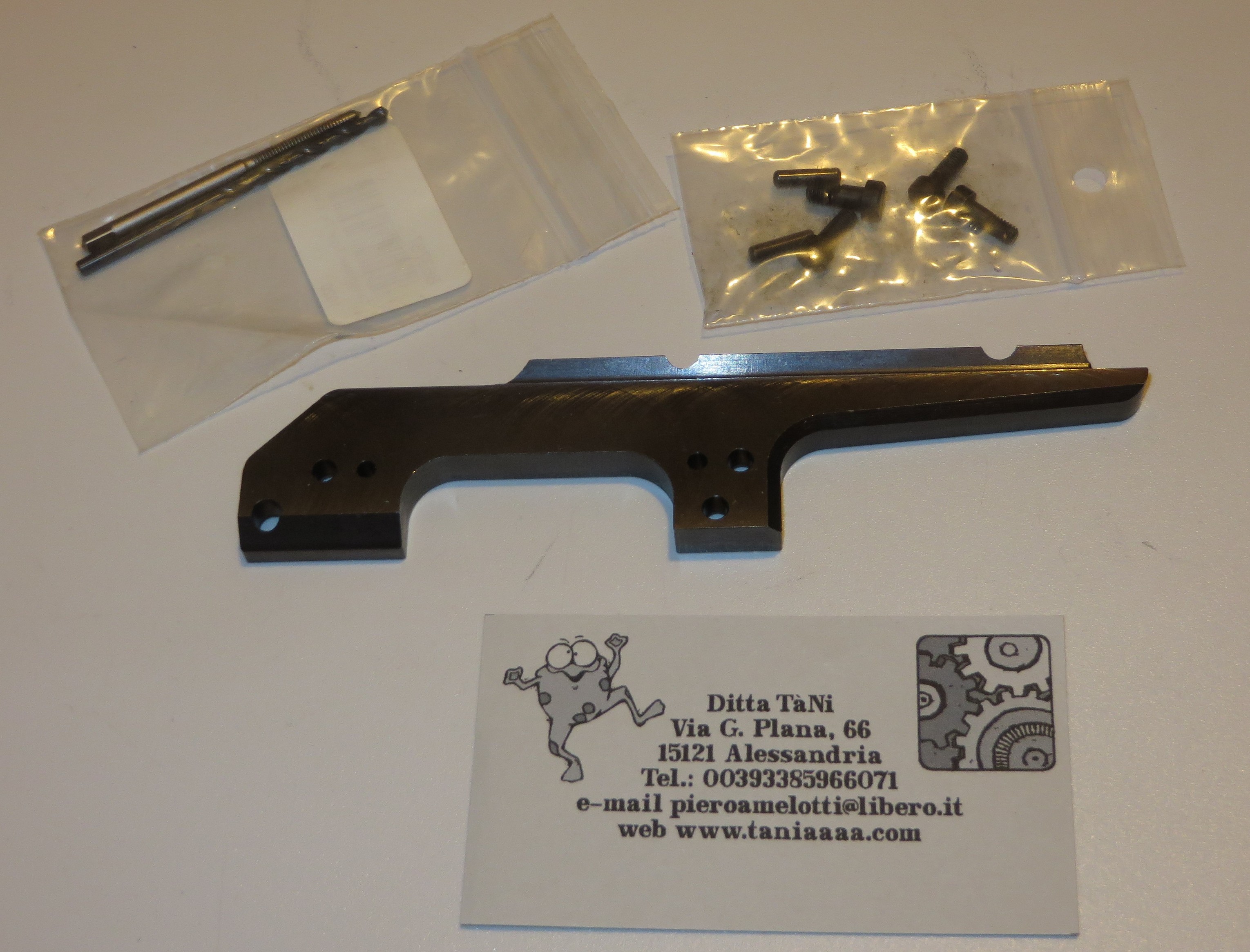

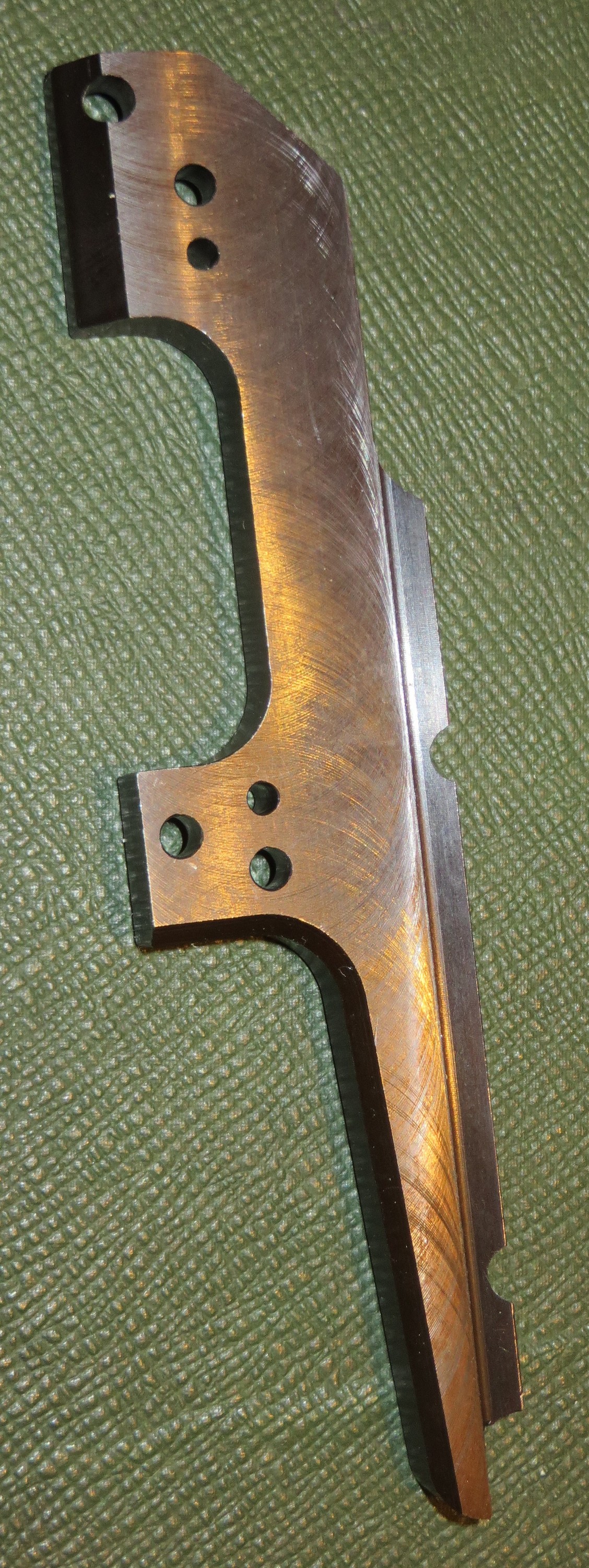

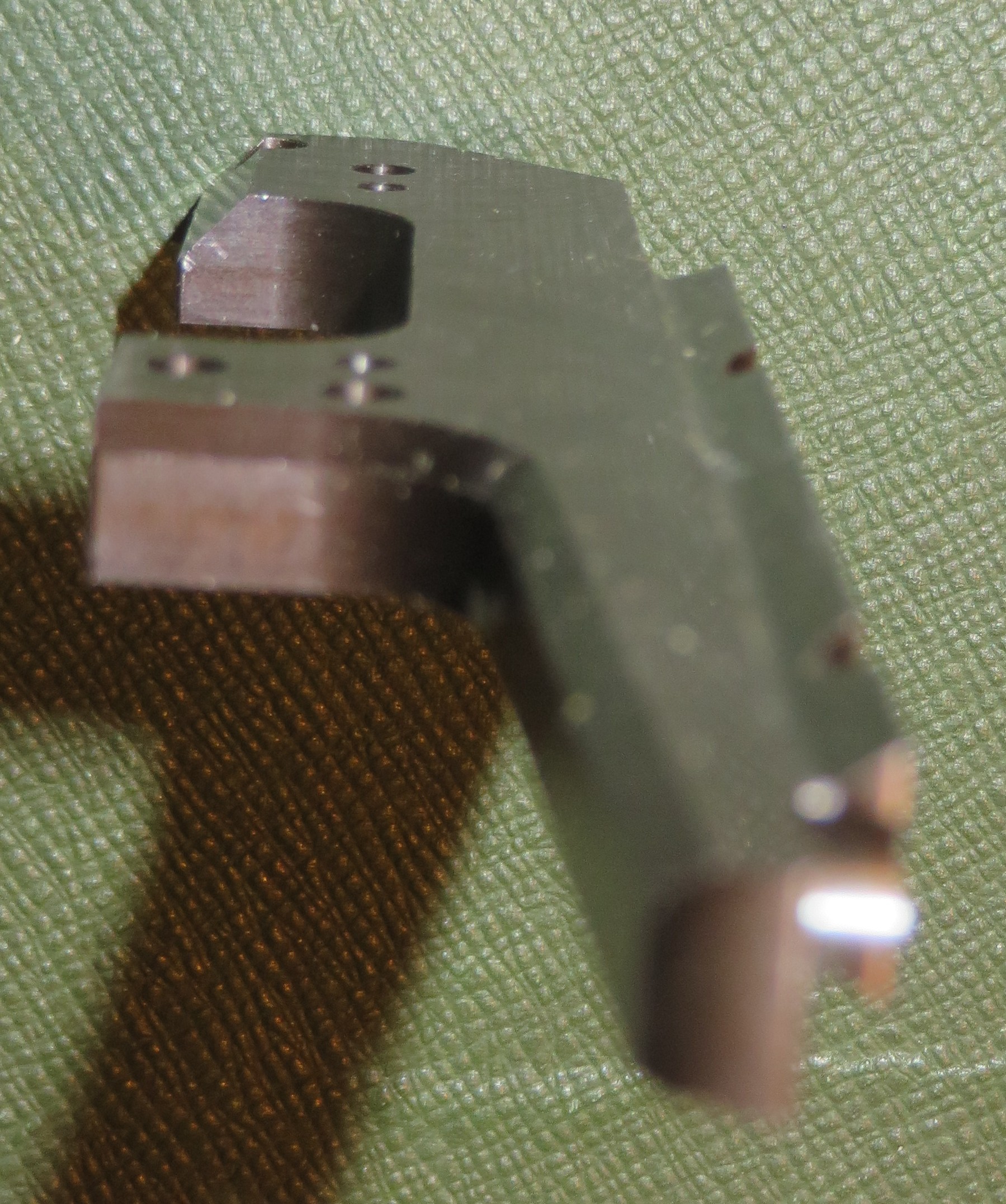

I bought one of the Italian replicas when they were on eBay, just for interest. I thought they were well done, but can't speak to their dimensional accuracy.
Attachment 123546Attachment 123547Attachment 123548Attachment 123549
