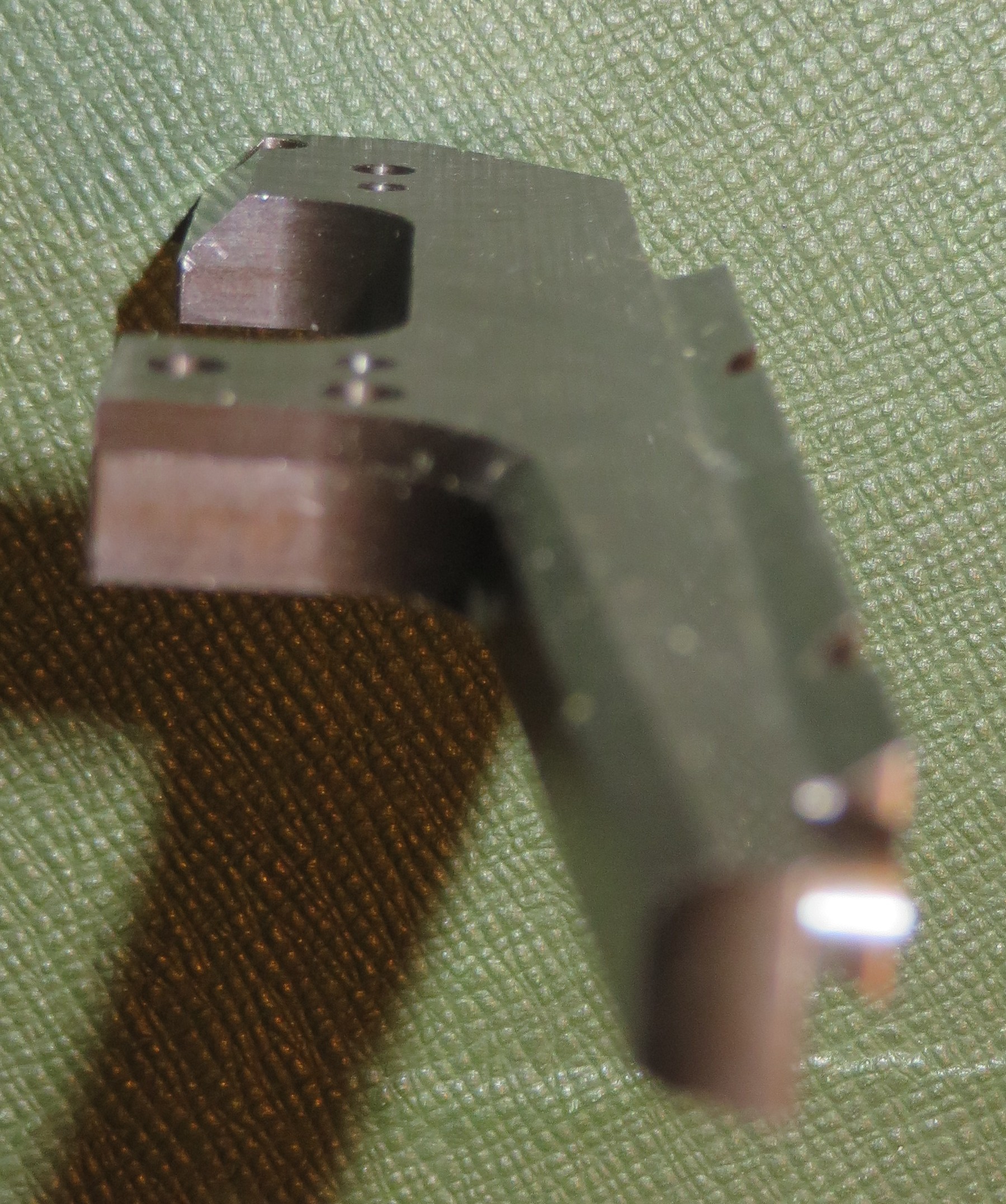

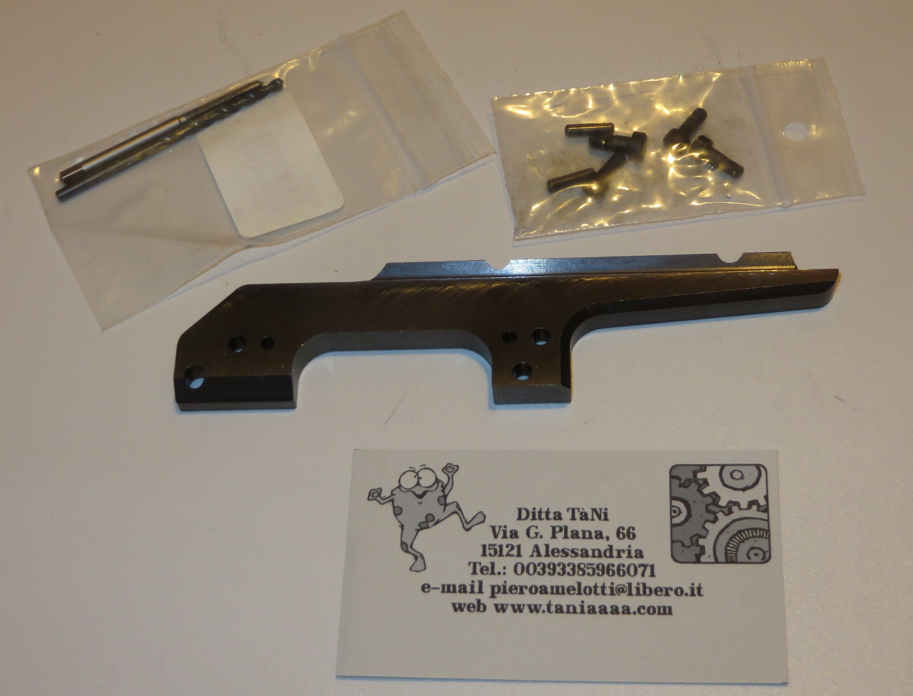

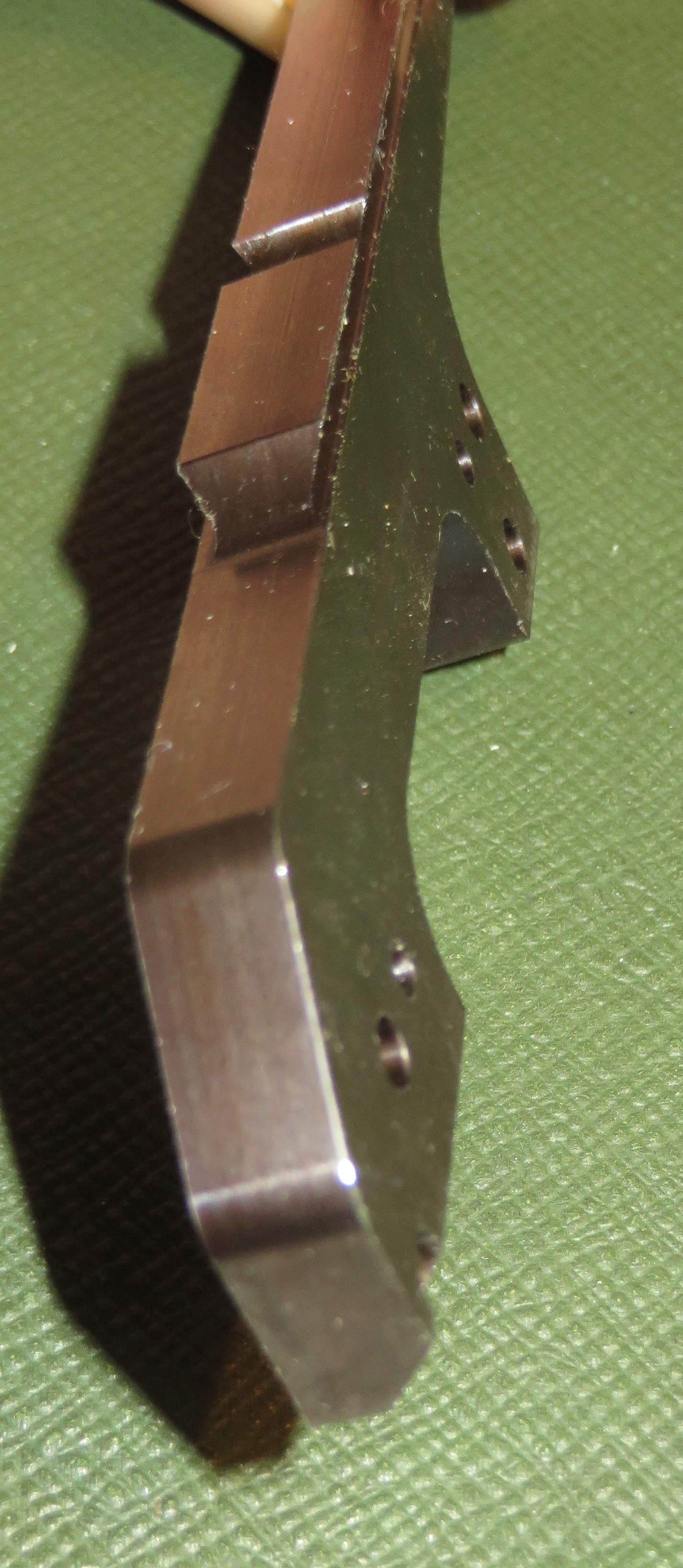

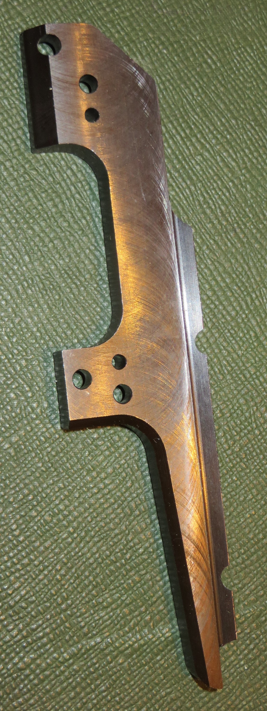

    I bought one of the Italianicon replicas when they were on eBay, just for interest. I thought they were well done, but can't speak to their dimensional accuracy.
    Attachment 123546Attachment 123547Attachment 123548Attachment 123549
    Cheers big fella, that’s very helpful, thanks for the reply. That’s very different from the original. Can you tell me what ring system it takes? It looks to accept a genuine griffen Howe just by looking at
    it.
