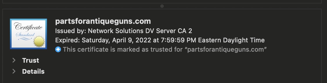

he let his certificate expire...yesterday in fact.
Attachment 125411
Ahh, OK, I thought that might have been the case. Hope he intends to continue production since I've paid for an adapter a month ago.
Let me know if he answers the phone....
His website is back up - I feel a bit of relief over that. Three months more to go for the adapter and shield...maybe less with some luck.

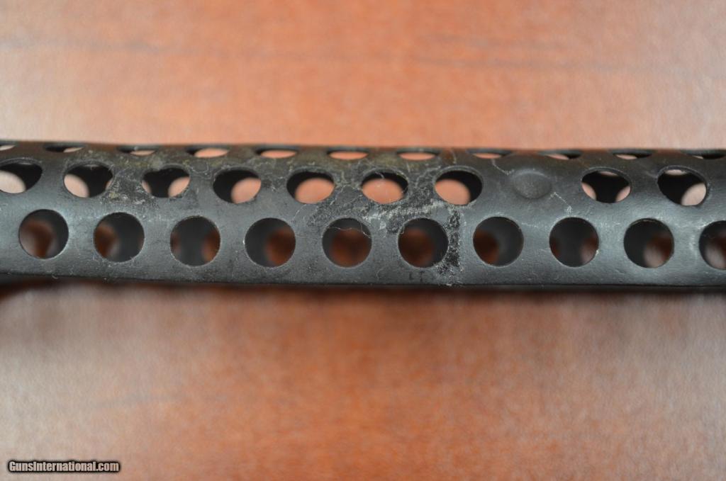

After studying a few original examples I'm pretty confident they were riveted. What I'm not sure of is if they were also silver soldered and the heads dressed down because the edge appear too uniform..
Some good pictures of what is hopefully an original here
https://www.gunsinternational.com/gu...n_id=100668926
I thought you were talking about making the standoff "dimples", like you see here
https://www.milsurps.com/images/impo...A5168JPG-1.jpg
Attachments to the bayonet adapter in the above look like obvious flush rivets. Lots of other pics they look like tac welds. Makes me wonder if they used different means between beginning and end production.

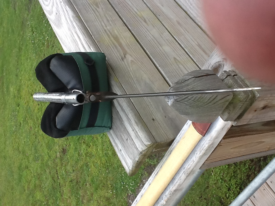

The barrel and adapter arrived this morning and is now finally attached to the receiver. I'm pretty happy with it considering all the effort and period of time involved.
Not real sure about the rerpro sling - I think it's ok late for post WWII (?)....I had a 1907 sling but sold it before the conversion.
Comments or questions are welcome.
