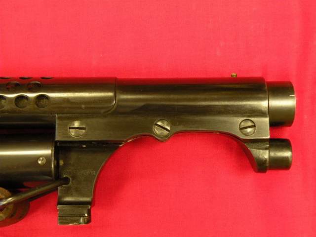

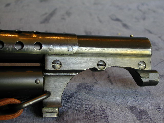

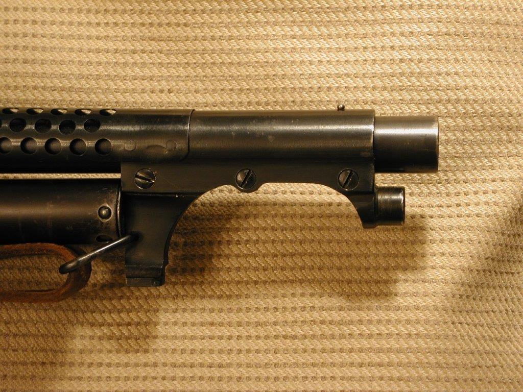

    So, here's what I've received.
    I’ve attached the following Winchester trench gun photos of the heat shield rivets:
    1. WWI Model 1897 adaptor (this gun is in about 98% condition. See how the rivets have been ground down flush with the heat shield so that when blued they do not show).
    2. WWII Model 97 adaptor (notice how the rivets are visible).
    3. WWII Model 12 adaptor (this gun is an unissued Model 12 in about 99% condition. The rivets are also visible).

    Fascinating. Thanks Tom! (and Jim!).
    Curiously, the first 1897 has muzzle roughly flush with the bayonet guide. The second 1897 it's proud, and the model 12 it's recessed. This means many of the "rules" the internet experts peddle are suspect (Say it isn't so!). In particular this one https://gunmagwarehouse.com/blog/the...o-get-scammed/
    I greedily would love to see many more pictures of these guns. With repro and fakes abounding, and pictures of verifiable originals hard to find or confirm, milsurps is the perfect place to discuss, as I trust pictures of our members' guns much more than the above link. Maybe a new thread if Tom is willing? I have a copy of the old Poyer (not the newer coffee table book) and Canfield on the way (knowing that there may be a few "softer facts" there too).

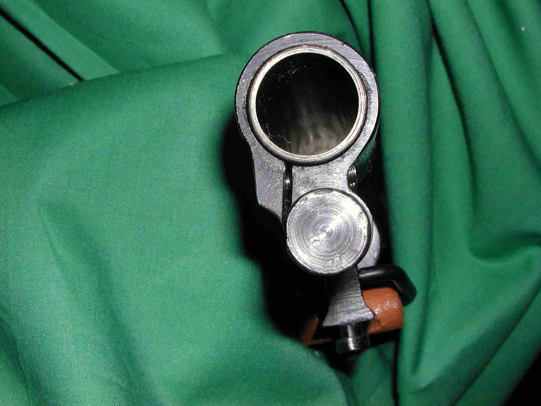

    The photos Jim posted for me are all from original trench guns. That it how the bayonet adaptors fit on the different guns. On the WWI 1897 trench guns the bayonet adaptor stud is flush with the muzzle of the gun. On the WWII 97 trench guns the mounting stud extends beyond the muzzle. Not sure why this is. Perhaps it has something to do with the fact that the WWI guns were solid frame and the WWII guns were takedown models. On the Model 12 trench guns the end of the bayonet adaptor that slips over the barrel is flush with the muzzle with the bayonet mounting stud protrruding beyond the muzzle. See attached photo. Notice how the muzzle of the barrel is in the white.
Name:	m12 bayo lug_01.jpg‎
