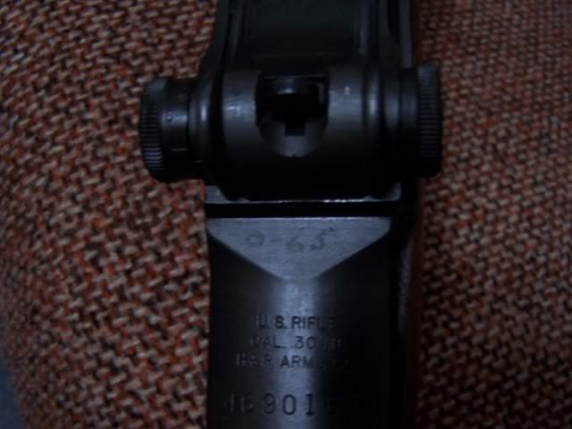

Don't forget the USMC rebuilds marked on the flat under the rear sight. marked as "O-65, 66 or 67".

Forgot about my 0-66https://www.milsurps.com/images/imported/deleted.gif

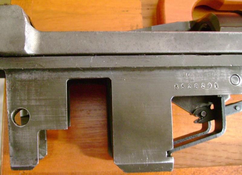

Just about all the armories who did rebuilds in the mid 1960s marked the right receiver leg becuase that's what they were instructed to do.
The armories/depots that come to mind that marked the reciever leg are LEAD (Letterkenny), RRAD (Red River), SA (Springfield Armory), TE (Tooele), A4 (likely Anniston), and BA4 (also likely Anniston).
Wasn't BA4 Benecia Arsenal?
I'm pretty sure Anniston used "AN" as well. I never saw or heard of a BA4, which is pretty neat. Thanks. I do have a rifle with A4 on the right side of the butt stock. There is also a "4" stamped over an unserifed "P" on the grip area. The receiver leg is unmarked. This was a USGI field grade, when they listed them that way.
Thanks, I checked my rebuild and it is marked BA4 5-64 on a 4.79Mil HRA.
Red River had two markings - "RRA" Red River Arsenal and "RRAD" for Red River Army Depot
AN is seen on stocks many times but I haven't seen it etched on a receiver (yet). Rebuild receiver etching was restarted (after SA-52) in mid 1963 at SA and the other arsenals that marked them followed shortly after.

Sorry to ressurect the dead here. But These marks would only be present if an Arsenal rebuild occured, correct? For example, my 1954 HRA still has the original barrel (presumed due to barrel date coinciding with serial range). Can I assume that while being rebuilt (probably by the Greeks and again by the CMP), it never went through a full arsenal rebuild.
https://www.milsurps.com/images/impo.../02/rrr2-1.jpg
http://img202.imageshack.us/img202/760/rrref.jpg
Correct, the code would only be found on the receiver leg if your rifle was rebuilt at one of the Arsenals. I wouldn't call changing out some parts by the Greeks, CMP or even the U.S. Military a "rebuild" or an "overhaul".
