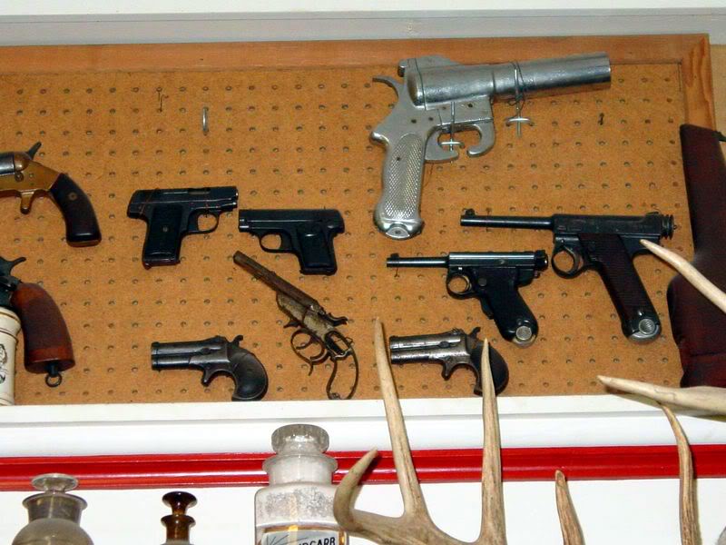

There was an old drug store on the old main street shops that had old guns all the way around the store hung on the walls near the ceiling. The owner of the store was an older lady and I asked her about the guns. She said that they had belonged to a previous owner of the store who has passed away. She didn't know anything about them and said they were in the store when she bought it so she left them up as decorations.
(I almost cried)

For the interesting post and the pics to go with it!! Did you notice some of the arms pictured on the wall of the establishment might well be NFA items ?? Maybe they are on a C&R list nowdays, I don't keep up with those things much. I haven't been to V'burg for a visit since early 90's when the kids were young and needed to see what it was all about. Was that "ironclad" a newer exhibit? or an ongoing one? I remember a "gunboat" that was more of a restoration than anything else. They had salvaged the iron parts, engines / boilers / etc., but all the wood was new production to "restore it".

Yes, I noticed some of the arms that were on the walls in that old drug store. https://www.milsurps.com/images/impo...0/Scared-1.gif
