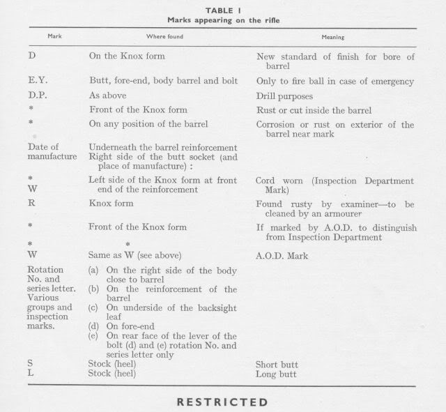

Does an asterix on the top of the receiver ring bear any relationship to DP? Does anyone know what it means (on a No4T receiver).
These all refer to the marks"*" on the barrel, including the knox form, is it of any further significance on the receiver ring?
ie. the mark would still be there once the barrel is removed and replaced
