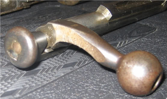

Looking VERY closely at the serial number, it looks like the last 2 (and possibly the zero) is original, but the rest has been rather spectacularly bodged. I will try and get REALLY good photos later.
