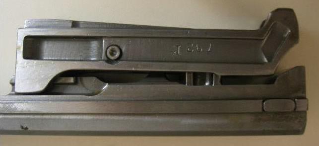

Peter,1st pics are mine,bit crap as not too good on flash.
https://www.milsurps.com/images/impo...nsion792-1.jpg
This one is from the US , I will request a full length photo and post back.Only have 2 half photos at the momment that I can find.
https://www.milsurps.com/images/impo.../09/ext2-1.jpg
https://www.milsurps.com/images/impo...9/ext3bb-1.jpg

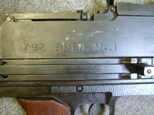

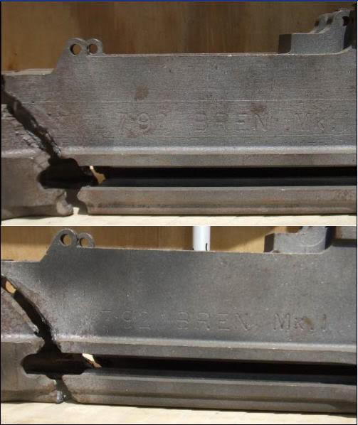

This is a post sample working gun that was purchased from Collectors Corner now I believe Ohio Ordnance ?
Mine is available for any non dustructive test .......no bloody great hacksaws !!! LOL :D

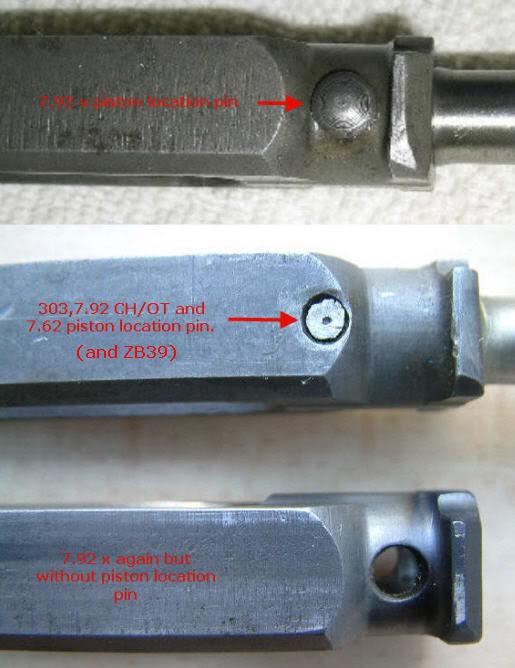

pistons/piston extensions again

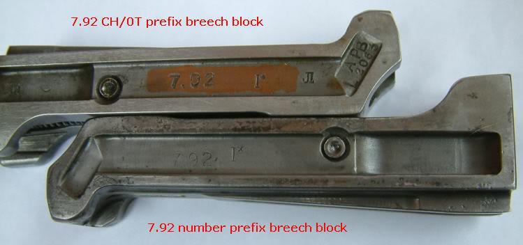

As a matter of interest regarding the 7.92 'sterile' Brens marked - 7.92 BREN MKI and the difference in the piston and piston extension between these and all other types of .303 and 7.92 (CH & 0T prefix) Brens some further info.
As mentioned earlier the piston location pin is further forward on the 'sterile' 7.92's on the very few that I have seen.
As there may have been some doubt on this feature on these few guns I thought it prudent to check with the examples (accession number 19760332-092, serial number 1-0001 and accession number 19760332-054, serial number 2-3429) held by the Canadian War Museum.
These were aquired by the CWM straight from Canadian Arsenals Limited so there provenance should be good.
Both Brens have been inspected and they do indeed have the same piston and piston extension as per other 'sterile' 7.92 Brens with the piston location pin further forward.
As the pistons and extensions are not threaded in these guns the location pin has to be further forward to mechinicaly join them.The location pin on all other types being at the bottom of the piston thread to arrest the possibility of the assembly becoming unscrewed.

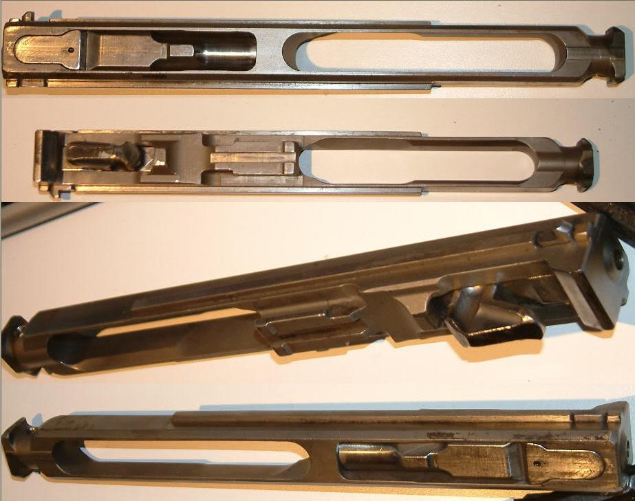

https://www.milsurps.com/images/impo...spistons-1.jpg
Apart from this being possibly the only item that could be simplified in the process of Bren production it would also require a smaller in length and larger diameter location pin.
As no other Inglis Brens have this feature would it indicate these were the last Brens produced there ?
