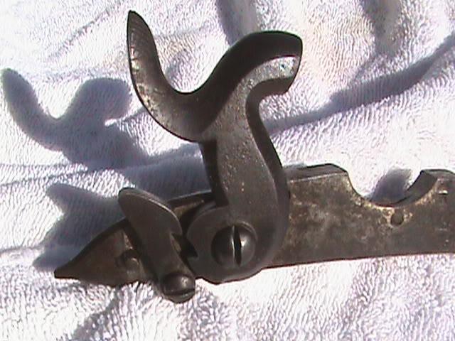

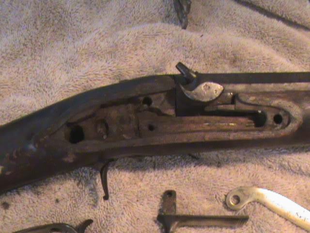

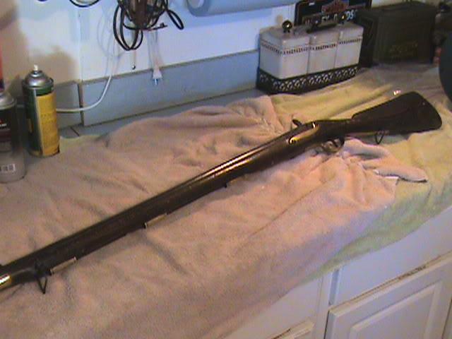

Found MUSKET in thrift store.
stats: 29" octagon barrel(rifled 3/4inch) barrel and other parts marked 566,has what i would call two royal crowns one on part you put the percussion cap on? the other in front of and above a K, an indented square with the letters AR inside and on the barrel OJR(or OIR) H No 58(or 581 or 58I its hard to tell for sure) (and the o in No is underlined) If this sound like something I'll post some pictures latter. It's really cool, but probably not worth too much as some one a long time ago made it into a lamp. crudely so the rifle was not changed but for some additional screw holes.

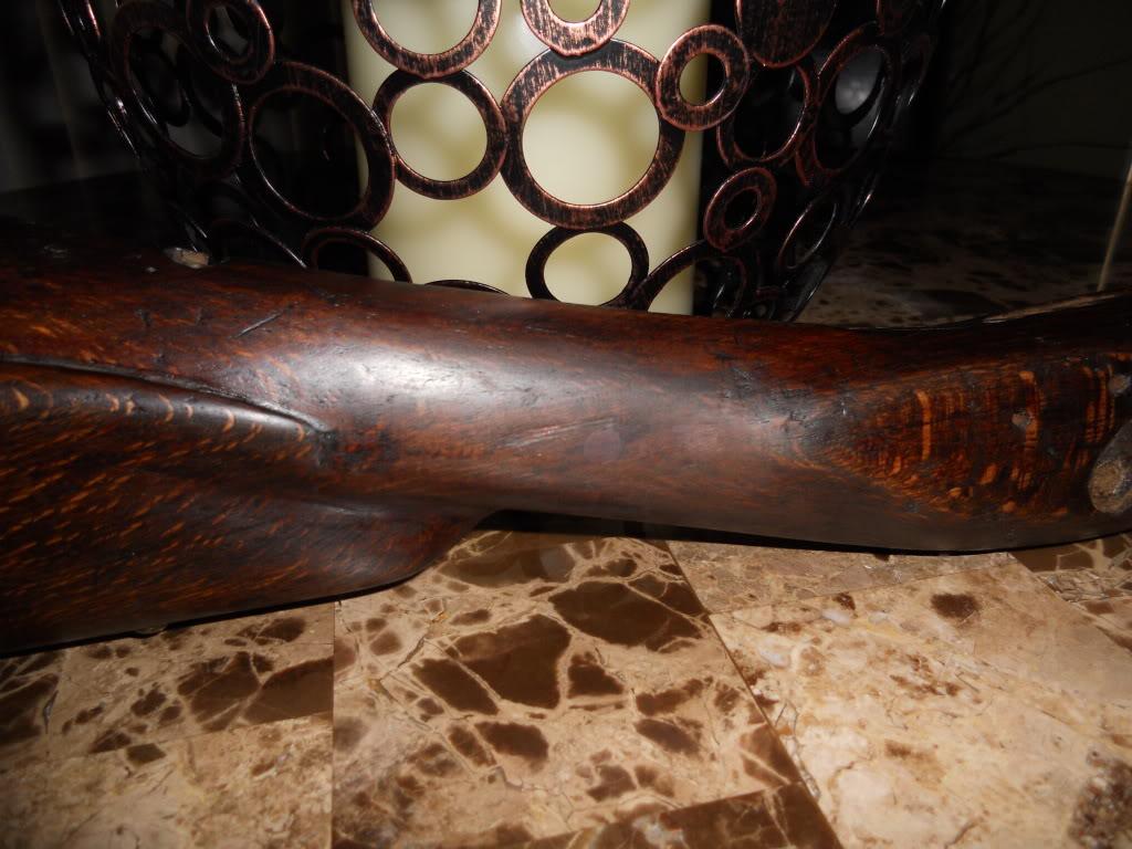

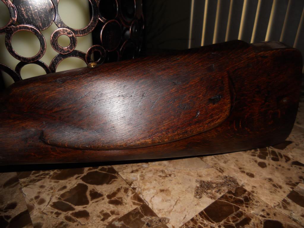

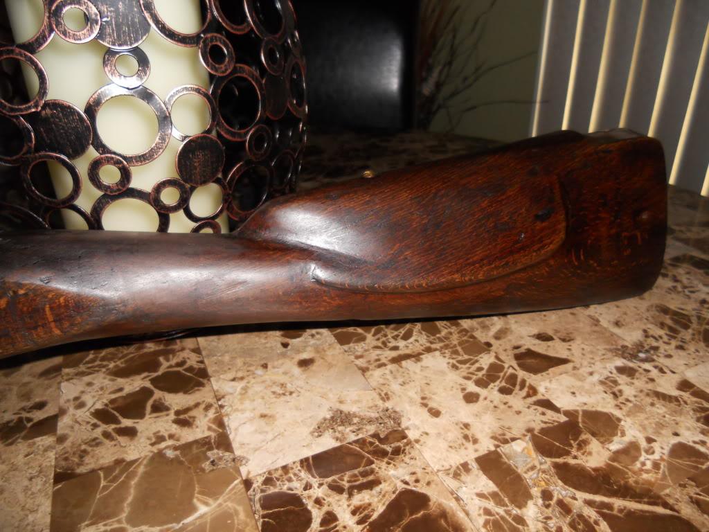

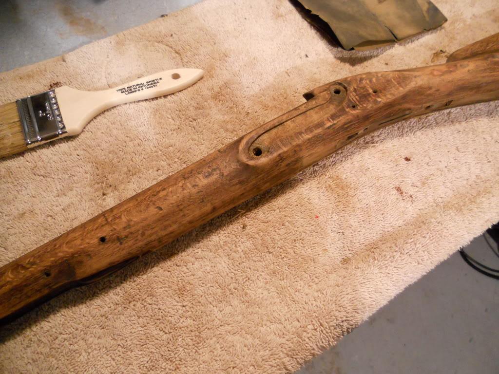

But, but, but... there is nevertheless such a thing as patina. The surface of wood darkens with exposure to light - and handling, of course. Surfaces are rubbed in a various ways, depending, on their position. Dings appear from everyday usage. Linseed oil and varnishes harden slowly over years. The combination of these long-term effects is a genuine patina. Complete removal of this layer will give any old piece of wood a falsely fresh look.
I am accordingly shocked when I read about ghastly recipes, such as smothering your gunstock in oven cleaner (which tends to be caustic soda with value-enhancing additives) and even putting it in the dishwasher for a really good clean. That wood is part of a complex tool. Skilled armorers spend years adjusting fits and bedding barrels so that rifles gives their best performance. The wood was selected, matured and carefully dried before use. It has settled down over a century or so to its present form. And now someone comes and soaks it right through to destroy that settled state and encourage it to warp, adds caustic chemicals to remove any real patina and really destroy the surface, attacks it with sandpaper, just in case there was still some original finish left, and presents the result as restoration.
Furniture restorers, museum staff, musical instrument makers - all would be horrified, and if they knew the term, would scream...
...that is NOT restoration, that is BUBBARING
It is therefore quite understandable, and correct advice to a beginner, to say "leave it alone", as some have already done. I said right at the start that it looked as if it needed professional restoration, and have not intervened further in the matter of restoration until now, as I am very busy on another "building site". But you have started the ball rolling by polishing the brass. And the surface of the wood looks as if it has been covered in floor varnish. That (if I am guessing right) is something to be removed. So before you do anything further, I implore you to read the series on refurbishing an Argentine Rolling Block on the restoration forum (The Restorer's Corner). Right from the start, please, as when I have managed this once, it would be pleasant not to have to repeat it!

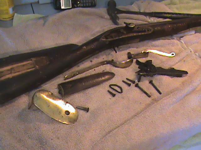

3 Attachment(s)
Let's face the challenge - very cautiously!
Quote:
Originally Posted by
DaveN
You wanted more.
I hope you have a barf bag.
Well that should quieten the "don't spoil the historic original finish" enthusiasts.
There is none to be preserved.
And the "part of its history" faction can look at those holes and weep.
"Now I know what you're thinking... is his store of wisdom exhausted?
Or has he still got some tricks up his sleeve to turn this dire wreck back into at least something you can hang on the well without being ashamed?
Well, to tell the truth, I don't rightly know myself.
Go on DaveN - make my day!"

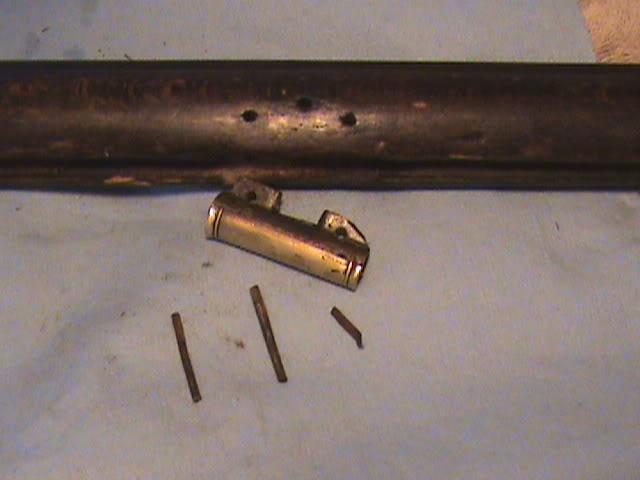

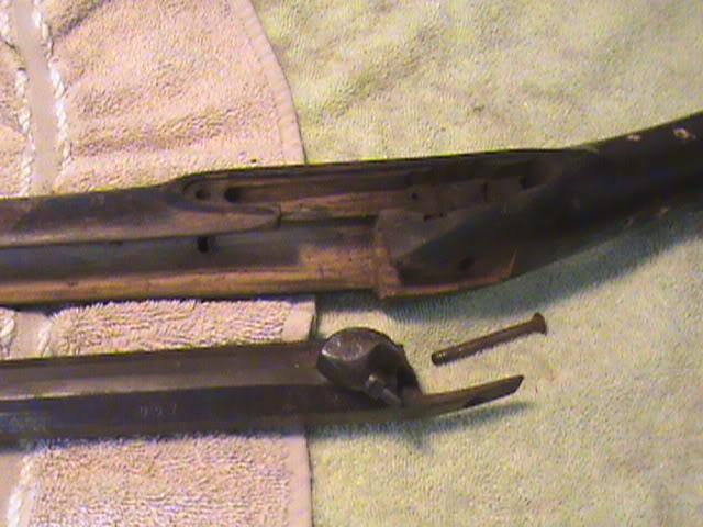

Well you saw my pics of the treacle rifle. That sort of thing is manageable.
But have you seen this?
Attachment 17545Attachment 17546Attachment 17547
That was the same type as the treacle rifle (Gew. 88 in carbine form - Kar.88)
In this case, Bubba beat me by sandblasting the entire rifle, beore smothering it with black paint. I keep it "because it might come in handy one day" - that's the pack rat syndrome for you - and as an example of Bubba's Inhumanity to Wood.

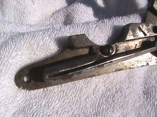

DaveN

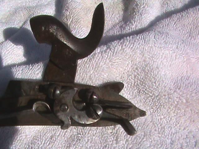

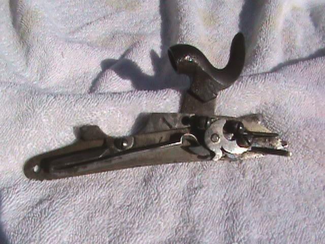

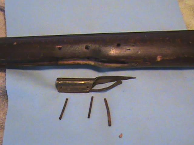

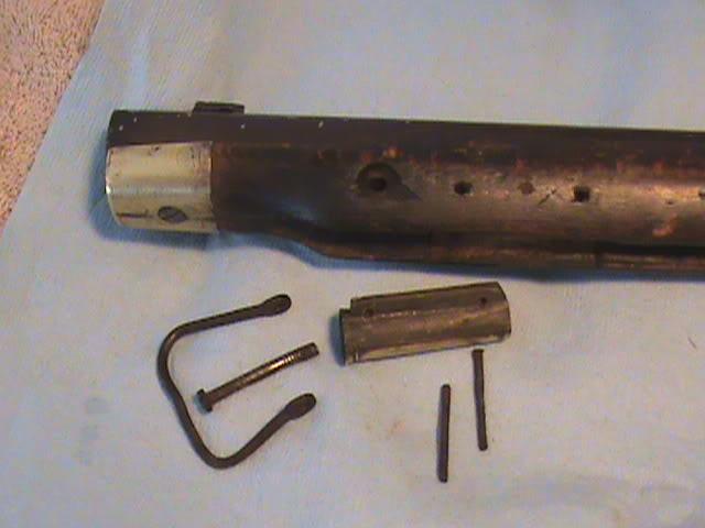

I'm not sure I have the ability to do this. My biggest worry is the pins are very rusty.
You are right to be worried. What this thing really needs is hands-on treatment by Claven2.
So Claven2, if you wish to take over here, that is fine by me.
Otherwise, DaveN, I shall now retire and have a good think how we can tackle this in a low-risk manner where you can stop at any time you feel it is getting to be too much.
IMOH you have nothing much to lose with that wreck.
