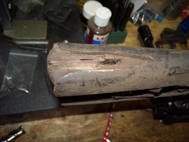

    This seems to be the worst stock damage inside the buttplate inletting. Looks like someone pried off the buttplate and broke out some wood. The break is clean and it looks really recent??? Like within the last few years? This should be an easy repair for when I'm inletting the buttplate.

    Repairing the missing wood inside the buttplate tang inletting, I used an old broken english walnut stock form the 1800's:
    Epoxy/sawdust patch for the forestock splits:
    Rough fit of buttplate:
    Getting better, but still some gaps:
    Before I go further with buttplate inletting, I need to patch the toe....

    The epoxy is dry so it's time to re-inlet the patch box cover.
    Started with different sized chisels and a small plane, these are the stock inletters "go-to" tools for coarse work:
    Getting close... the glue line is virtually invisible even with the stock unstained and un-oiled.
    And it's inlet.
    Now to file the buttplate inlet to match and dowel repair the old screw hole so the new one can be drilled.
