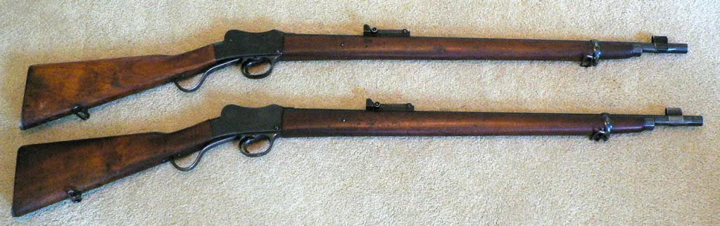

See my babies?
https://www.milsurps.com/images/impo...niCadets-1.jpg
