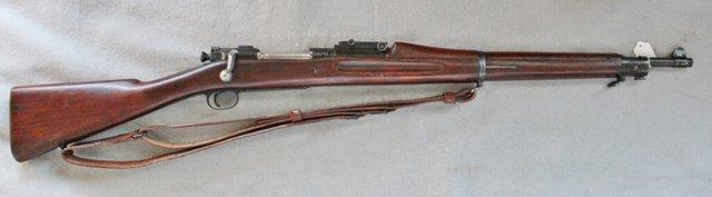

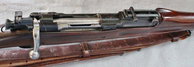

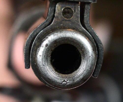

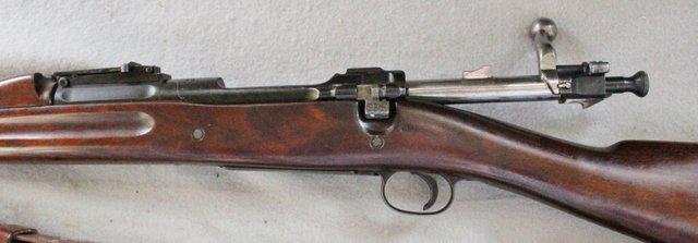

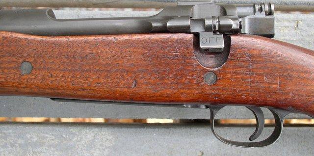

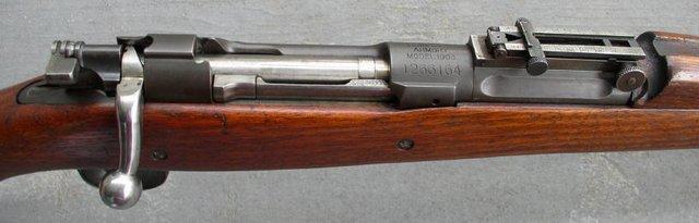

So then the question is, how to you tell a National Match rifle 1920 and earlier since they had no star gauge or inspection number? Thanks to John Beard and other seasoned collectors this is what I am passing on the the forum. National Match rifles appear in a serial number block....not always as there are exceptions. NM rifles have a finely checkered buttplate, no 2850 yard notch, in-the-white bolt with a swept handle and in 1919 and 20, a serrated trigger. Serrated triggers were started circa 1910 and replaced by smooth trigger with the Mark I and lasted until 1923 when serrated triggers were resumed.....Only NM rifles had the serrated trigger until 1923. Early rifles also were treated with Asphaltum. Asphaltum was applied at Springfield Armory and was part of the original finish. It usually (not always) appears on the barrel and upper band, floorplate, front and rear sights and trigger guard. Be especially careful not to use aggressive solvents on these parts as they will remove part of the original finish!

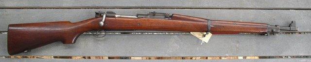

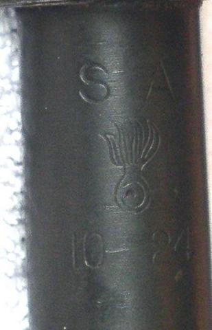

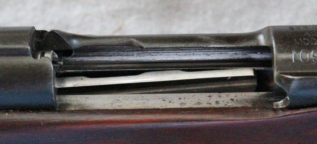

1919 NM Rifles RIA 387883 and SA 1094096
