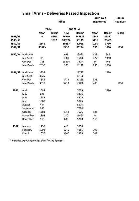

There was some new production, possibly makework to keep the workforce intact.
I drew the following figures from Ministry of Supply statistical publications.
https://www.milsurps.com/images/impo...08/large-1.jpg

Well, I never knew that ... Lesson for the day, thanks guys
