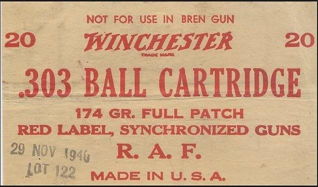

Here's the RAF ammo Roger mentioned. Does anyone know why it was not suitable for the Bren gun?
https://www.milsurps.com/images/impo.../pHWw5Qi-1.jpg

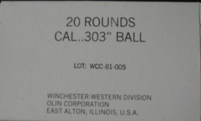

Winchester also loaded some in the early 80's. Wonder who it was for?
https://www.milsurps.com/images/impo.../uXX6pQc-1.jpg
It was rumored to be for Afghanistan at the time.
re "Not For Use In Bren" this ammo was weaker in head than standard and gave case separations.
I wouldn'tsay that the case was weaker. The bren has a distinct primary extraction phase during bolt unlocking whereas the Browning extraction is most ferocious. I'd say that the full patch was the reason.

I know the WW2 contract 303 from Winchester was loaded with ball powder but is it a non corrosive primer? Full patch is just another way of saying Full Metal Jacket back in the old days. Winchester would use that wording on just about all of it's FMJ ammo from just before WW1 up into WW2.

The stuff is NOT mercuric primed, thus it is reloadable brass. Better to sell it as "collector" ammo and buy nice new commercial brass and primers with your winnings.
Got the info about the weaker case and not use it in Bren from a WW2 vet who had a long career as a SA instructor in reg force. Otherwise he liked it as it was noncorrisive.
I have found this ammo separates after only few reloads in comparison with DI which lasts must longer which indicates a weak case.
Full patch Means full jacketed like other MkVII ctgs.
