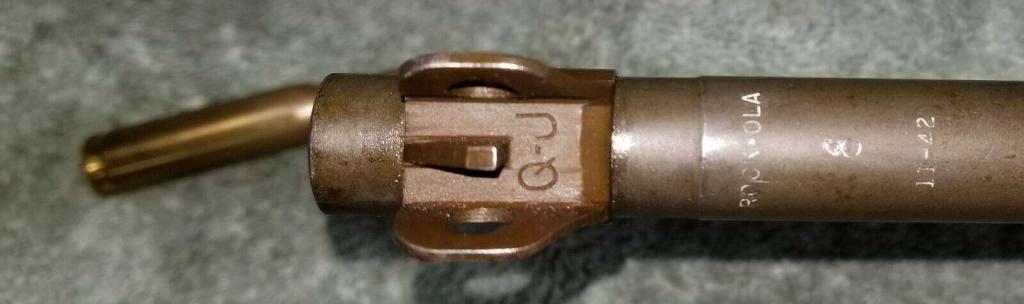

Early Q-J Frt Sight Blued Band, Parked QU Swivel
Thought I'd add this QHMC Type I front sight picture I seen today on a ended auction. I've never seen one of these in person.
Was attached to a 11-42 Rock-Ola barrel complete with Type I blued band and QU Parked swivel. Ran over $800.

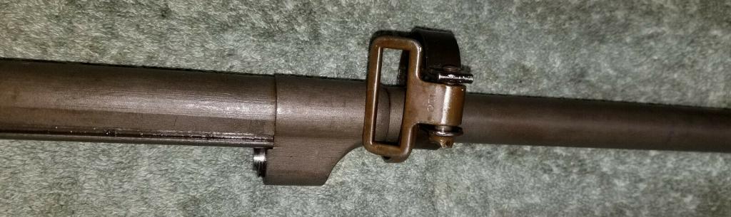

Wanted to add picture of Blued band with parked swivel so all know they did come this way.
https://www.milsurps.com/images/impo...2/sl1600-3.jpg
https://www.milsurps.com/images/impo...2/sl1600-4.jpg
