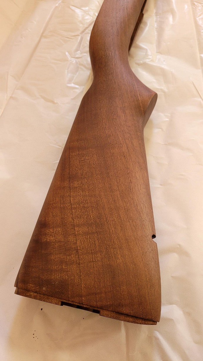

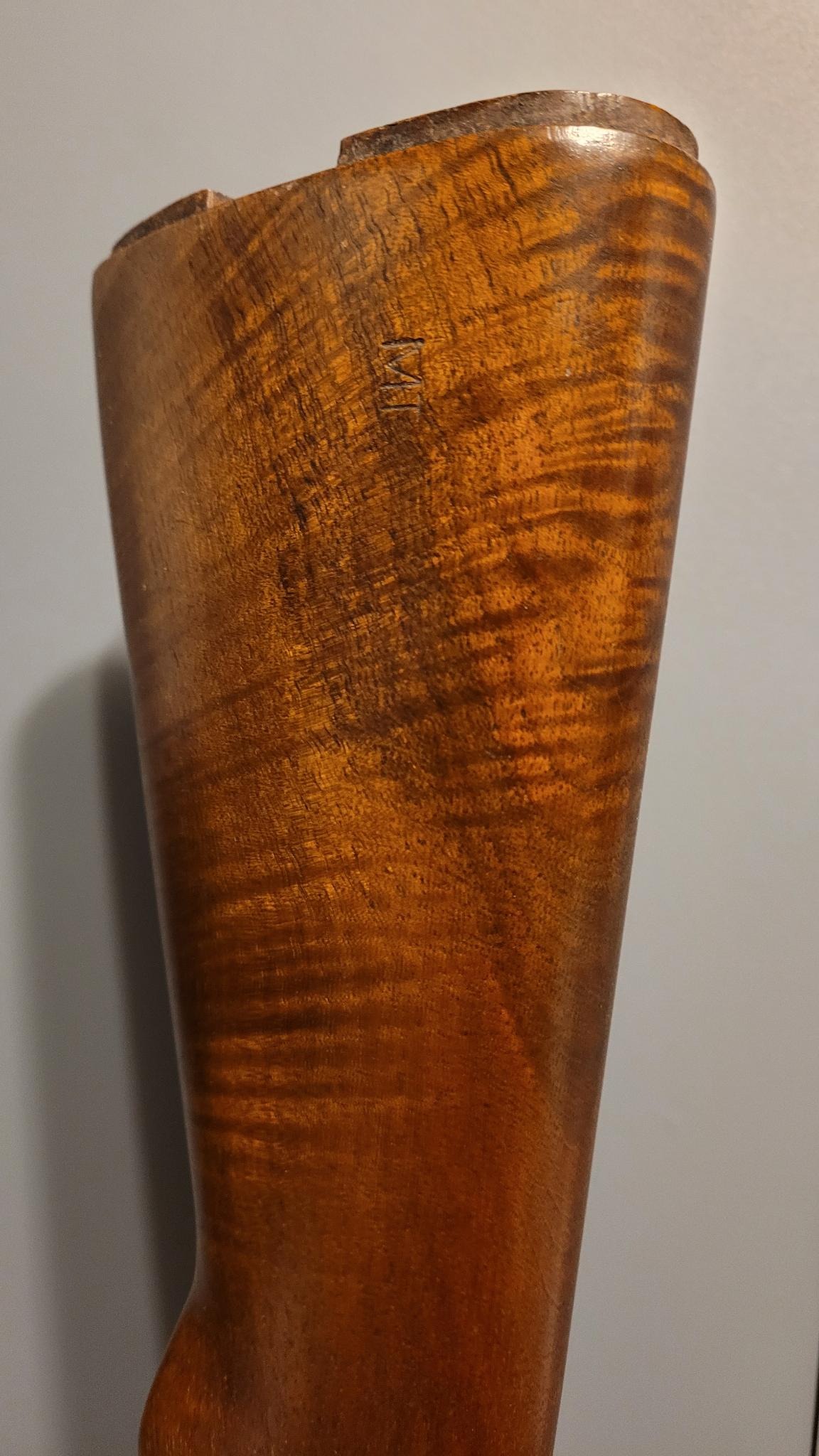

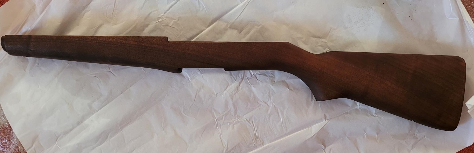

Greetings! I was looking at some of the pics provided by RCS of early gas port rebuilds and something spoke to me. As I enjoy shooting, I would like to build something that would approximate one (well, as close as I can at the moment, I have some grooved handguard clips and lower bands).
I’m looking for the “proper color” if such a thing exists. Normally I strip all previous stain (even if new) and use a dye

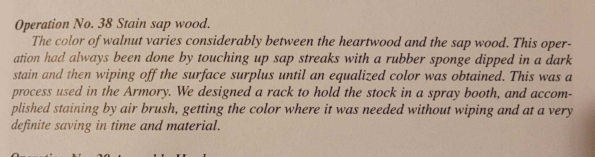

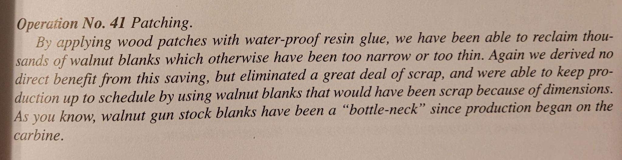

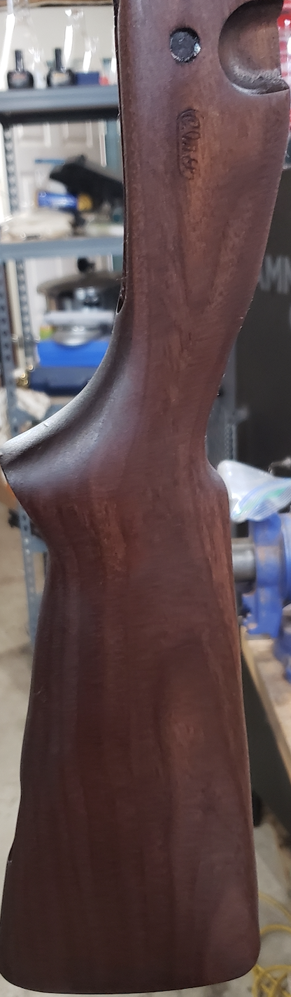

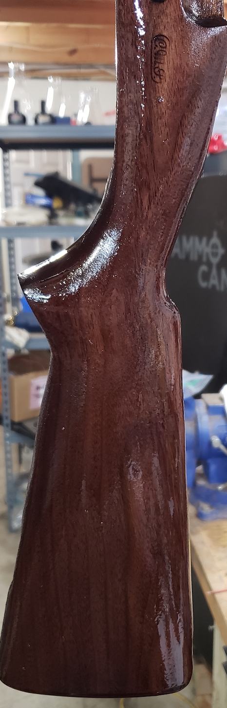

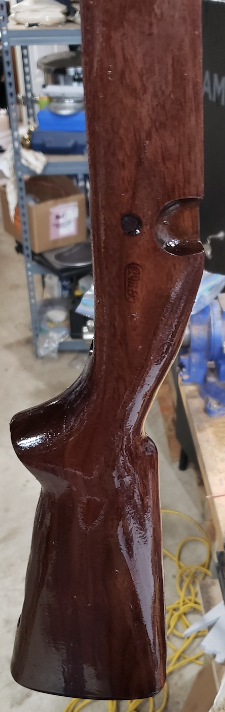

Repair of "Scrapped stocks" as well as additional reworking of stocks and blanks
To meet final quotas or fill the final order they requested they be allowed to complete? If the gov wanted to stop procurement could a manufacturer be reasonably assured that that component wouldn't go into service for use for a long time if ever? Its only supposition unless I can find something written.
Also, we have record of 30,000 scrap Rock-Ola M1 Carbine stocks being reworked by Overton.
Wish there was a way to get some additional insight into this. When a stock was truly condemned how would they have been dispositioned?
Also some additional comments from the book about Overtons heavy patching, light patching, as well as equalizing color by hand with stain.
I'm not making any claims that this was done with the Garand or M1903A3, but its interesting that it was done.
The person who wrote the book was so keenly interested in the Overton saga that he even has write-ups on many of the employees during the war years.
