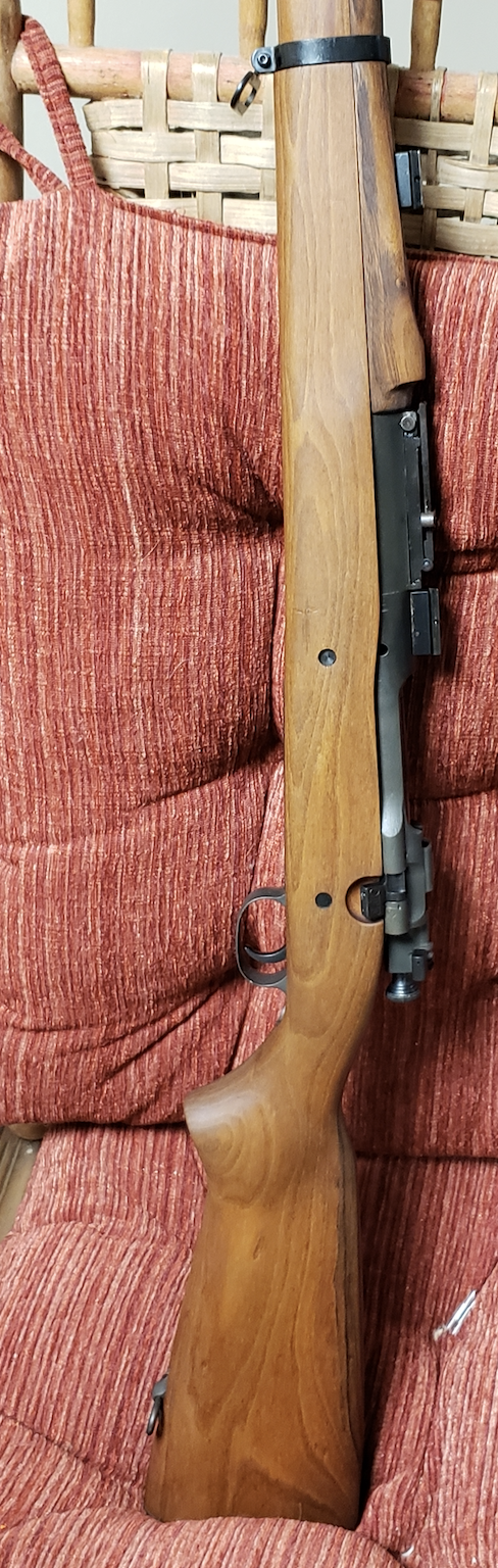

    Gorgeous. What did you use to strip the old coating? Solvent? Turp?

    I used acetone to get most of all the grease out so it wouldn't clog my sandpaper , then 80 grit paper to get the rest. Those new cheap replacement stocks (Minelli's included) are usually very fat and so plenty of wood to work with. This one had an extra 1/8" on either side of the handgaurd. I used files to get the sides and shape nice and flush after the first rough sanding, then I sanded with 100 and finally 150grit (by hand). Makes it nice and smooth, but still leaves enough to feel the wood under the finish, like an original. If I'm restoring a stock and trying to preserve the 80+ year old color, I use lacquer thinner followed by raw linseed or my red oil, depending on what the color was like. It works slower than acetone. If not careful, acetone will take everything away in a blink of an eye.
    FYI, the stain on those minelli stocks is really just a light spray tan. It is only there to hide the variation in the cheap walnut. It comes off with a very, very light sanding. You could get it off completely just scuffing with 150+. I have done several of the minelli 1903 stocks. One of them had beautiful figured heartwood on one side, with red and purple swirls on the butt, and the other side was light sapwood.

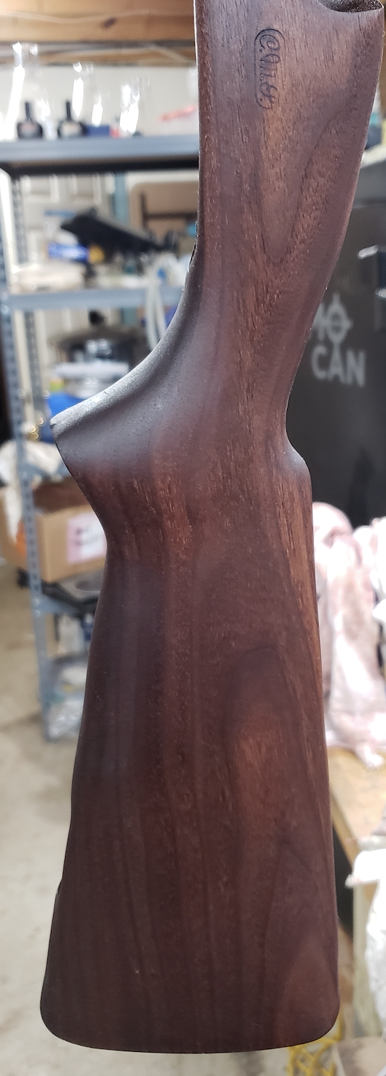

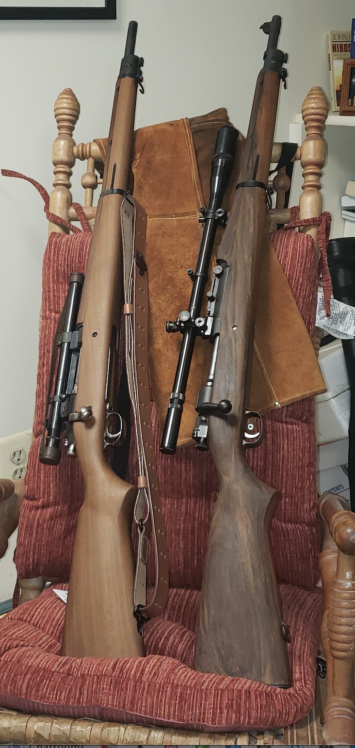

    jesse_ and I have been chatting about stocks/manufacturer/color on PM, and since my thread photos are no more, here are some pics.
    2 Minelli stocks. I had threads with lots of pics that followed rescuing them from sporters. They are both finished with just plain organic raw linseed oilicon from the health food aisle of the grocery store, and lot's of time hanging in the back of the shop. That stuff is pretty good on oatmeal too, even better mixed with molasses, but that kind of defeats the health centric purpose. Oh well. The point is, there is a lot of variation in the type of walnut you get under their spray tan.

    Here is an update on the CMPicon stock I started above over the weekend...another coat of home-made red oil applied this afternoon, and wiped down a couple hours later.
    And here is a NOS Keystone Scant. Keystone and some of the other contractors stained them dark reddish-brown. Judging from the depth of the stain when I took it off, it was water or alcohol based. Oil based stains don't ever penetrate as deep as these were. Would have looked great just oiling it, but it had a severe blemish on the butt that needed sanded out. I finished it with just my home-made red alkanet oil. No initial alkanet/turp or alkanet/alcohol stain like I'm doing now.
    I'm not claiming any of my work is perfect or authentic. Fact is I generally care more about how it feels in my hand then how it looks in the end. To get an authentic feel, don't sand above 150 grit (sandpaper manufacturers vary, 100-150, by hand is a good stopping point depending on the paper. Cheap garnet paper from harbor freight, 100 is perfect. High quality cloth backed paper, I go to 150). For looks, I wipe down my raw wood with plain turpentine or mineral spirits in order to judge the variation in grain and quality of the wood, then plan a course of action based what this wipe down looks like wet, e.g. whether to stain first, red-oil applications etc.
