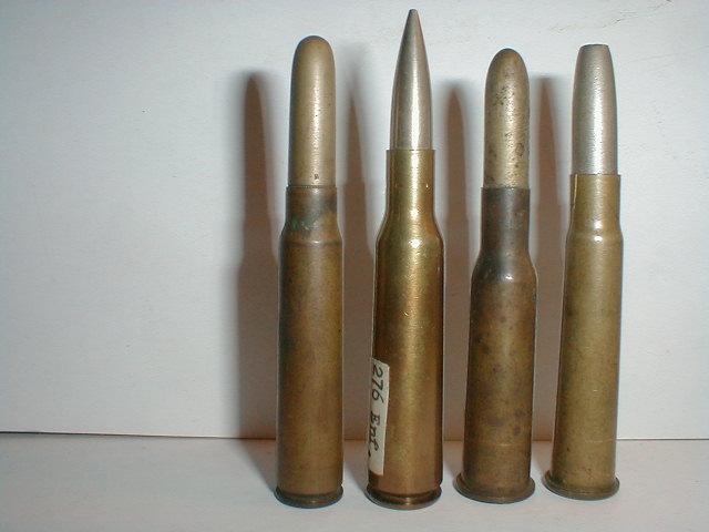

.577/500 No.2 Black Powder Express
From the collection ~ .577/500 No 2 BPE paper patched.
You'll notice in the top shot of the projectile there seems to be a copper plug in there possibly to aid expansion of the projectile?
What is the consensus on that theory!
Developed as a black powder round some time before 1879 by necking down the .577 Black Powder Express to .507-inches (12.9 mm) for use in single or double rifles, as well as a variety of Martini-based lever rifles.
MkVII 303 for scale

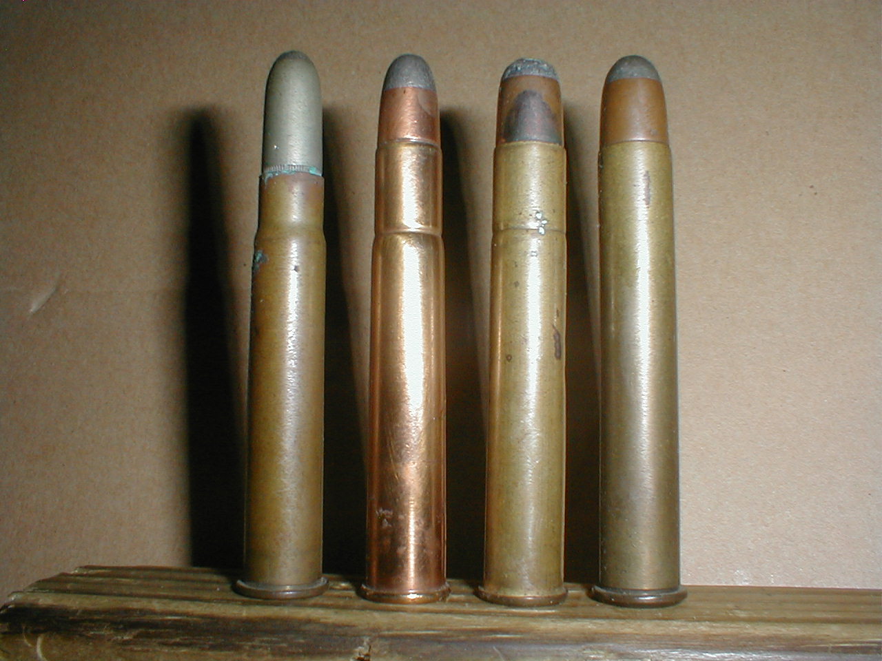

Kynoch .577 BPE 2 3/4 inch
My .577 Black Powder Express 2 3/4 inch
The .577 BPE originated around 1870 with the 21/2-inch variant.
The 3-inch cartridge has survived to the current day as the .577 Nitro for Black, the same cartridge loaded with mild loadings of modern smokeless powder, carefully balanced through trial to replicate the ballistics of the Black powder version.
The 23/4-inch, 3-inch and 31/4-inch cartridges were later loaded with smokeless cordite to create the .577 Nitro Express, with the 3-inch version becoming the most popular.
These cartridges were used for the heavier species of soft skinned game, including dangerous ones such lions, tigers and wild boar. Its also useful under all but the most adverse condition against thick skinned quarries such as the gaur, cape buffalo and even elephants.
MKVII 303 for scale.

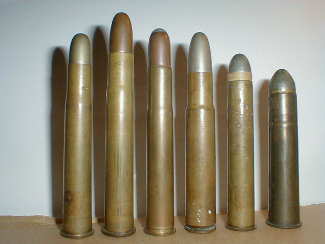

400/350 Kynoch Nitro Express
My 400/350 Kynoch with FMJRN
Introduced in 1899, the .400/350 Nitro Express is a rimmed cartridge originally designed for use in single-shot and double rifles. In 1899 Rigby approached the engineers at Mauser to make a special Gewehr 98 bolt action to handle this cartridge, its introduction in 1900 was the birth of the magnum length bolt action, paving the way for such cartridges as the .375 H&H and .416 Rigby.[3]
The .400/350 Nitro Express fires a .358" diameter 310 grain projectile at either 2000 fps or 2150 fps, depending on the source.
MkVII 303 for scale.

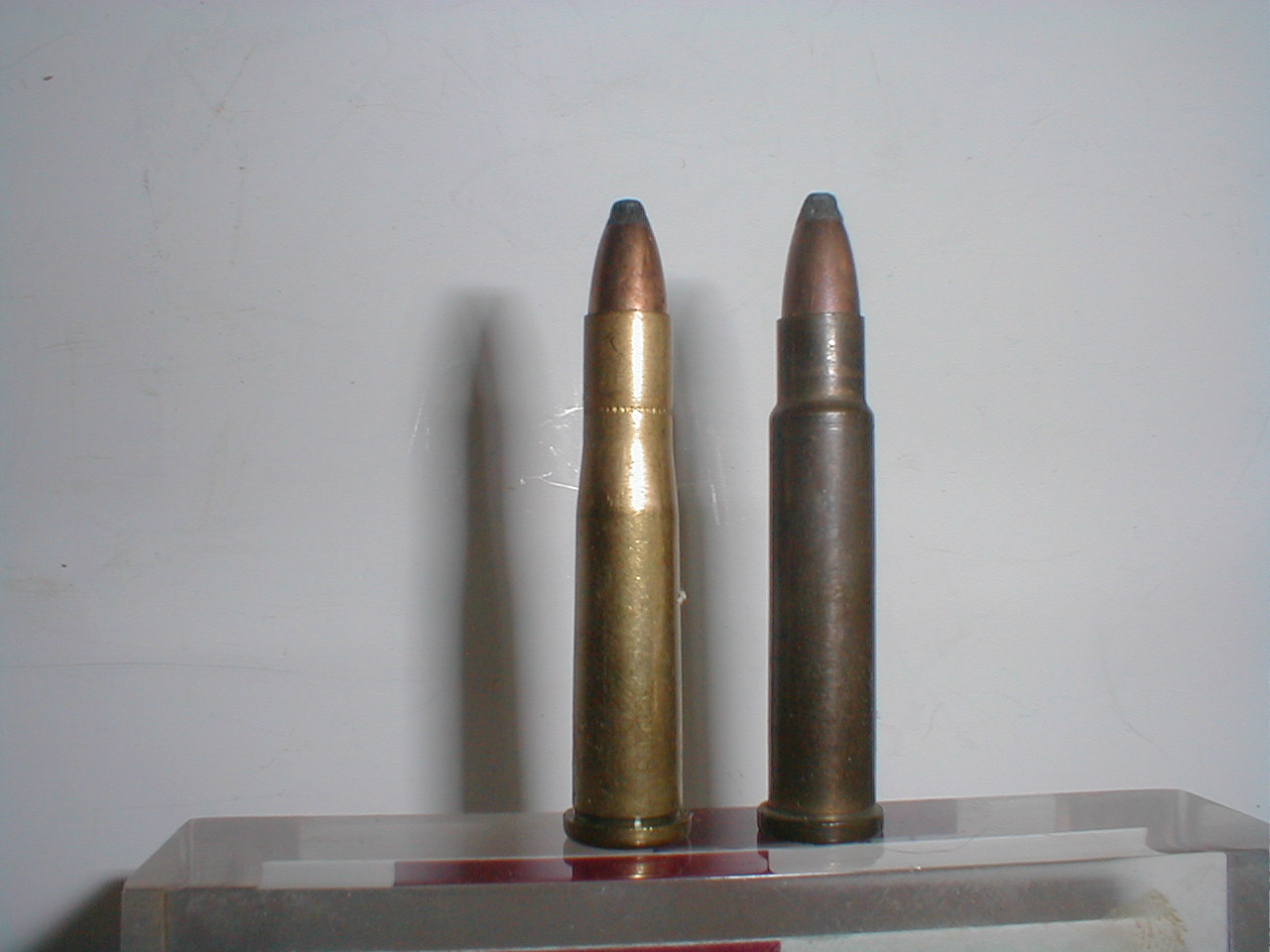

Kynoch .318 Westley Richards
My .318 Kynoch nitro express for the .318 Westley Richards.
Westley Richards introduced the .318, primarily for use in their M98 Mauser and later their P14 Enfield based bolt action sporting rifles.
The .318 Westley Richards is a rimless bottlenecked cartridge primarily intended for use in Africa. The bullet diameter is actually .330", the naming is due to British nomenclature which sometimes names cartridges by their land diameter rather than the more commonly applied groove diameter.
Westley Richards offered solid, soft-point or the revolutionary LT-capped[note 1] bullets in two loadings, the more common being a 250 gr bullet with a listed speed of 2,400 ft/s, whilst a lighter loading firing a 180 gr bullet at 2,700 ft/s was also offered for lighter game. The 250gr bullet possessed high sectional density and thus excellent penetration.
In my book I have on "African Rifles and Cartridges", by John "Pondoro" Taylor wrote that the 250gr .318 Westley Richards is "fully capable of driving its bullet the full length of a big elephant's body.
