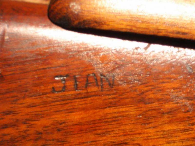

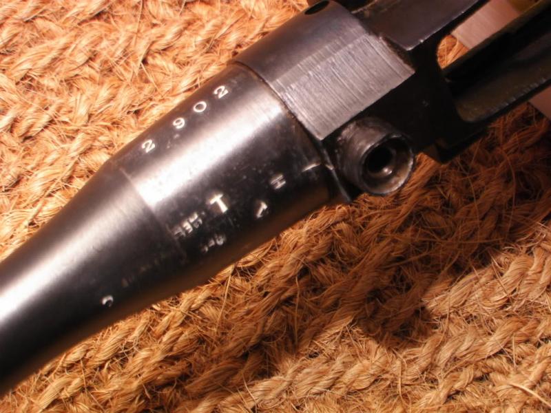

Hello all! I'm new to the forum and Lee-Enfields. I have recently aquired my first No.4 Mk1. The rifle is marked on the butt socket M47 1943 AQ2902. The bolt serial number is also AQ2902. As the title of the post indicates this rifle is not marked TR nor does it have a T marked anywhere on it. I understand that this makes it highly suspect as a genuine sniper rifle. The strange part is the buttstock (with cheek piece) is clearly stamped S 51. I firmly believe that it has been attached to this rifle since day one. Also, the small 1/8" S is stamped on the right side, behind the receiver ring, just above the wood. The rifle has properly staked, matching finish, scope mounting pads, and scope mount with a vintage Weaver K4 scope mounted.
Though the rifle looks like it's been well used, it still shot better than 1.25 MOA with the S&B ball ammo I used.This rifle was a real pleasure to shoot so I'm pleased with it no matter what. In fact, it is more accurate than either of my two WWII era Remington 1903's. What are the chances that this rifle actually is a sniper rifle?

The Century rifles were not LE sniper rifles. But from what you posted your rifle also lacks some of the reported stamps and details that the Century rifles are reported to have had.
It therefore seems unkilely that your rifle was a century-sale.
It could be an older T rifle -read the early part of the above sniper story where the early units were not stamped T or TR but you need to get someone to tell you the manufacturing date of your rifle for this to be a "true issue"as all later T's had the -T- and -TR- stamps.
Is the scope pad serial numbered to the receiver?
If it is -good.
If it is not serialled at all and the screws are staked you have a parts gun in all likelihood.
If the scope mount is not serialled to the gun you have a rebuilt rifle or possibly a parts gun built up by a private individual.
BUT IT IS ALL IN QUESTION YOU NEED TO POST US SOME GOOD PICTURES OF--
a)receiver left wall--good resolution pic
b)left butt socket wall -good pic
c) wood markings on butt and foreend
d) -S- stamp in the receiver ring-these have been faked in the past.
e) close up of the scope pads and screws
f) close up of the scope mounts,screws and stamps (numbers)
g) closeup of the rear sight
Then all the seriously informed folks here can make a more informed decision.
You might have a scrubbed rifle--cleaned disassembled and blasted so the markings might have been lost, this is why we want to see the remaining marks and whether or not they are clean and visible or light and barely visible.
Info info info
