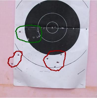

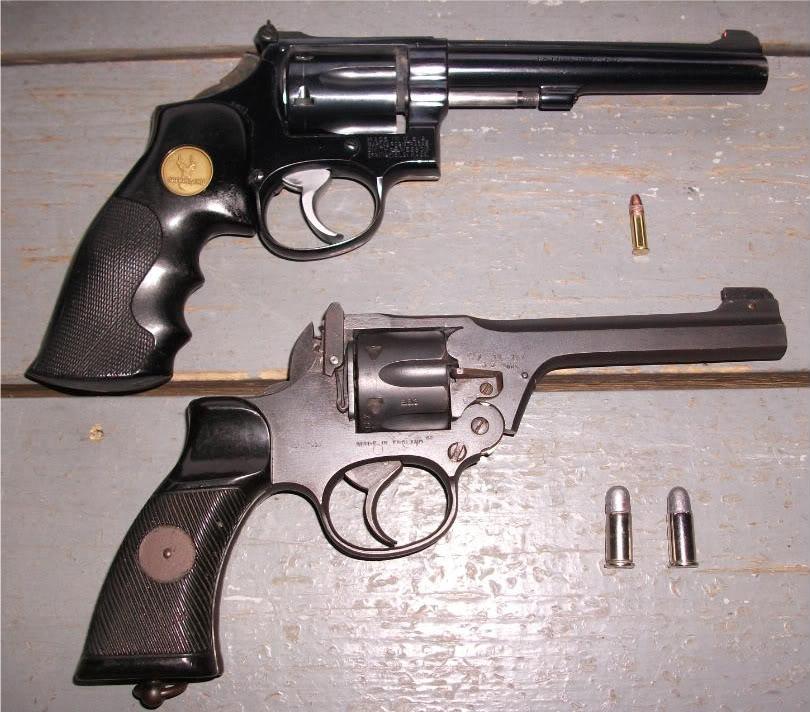

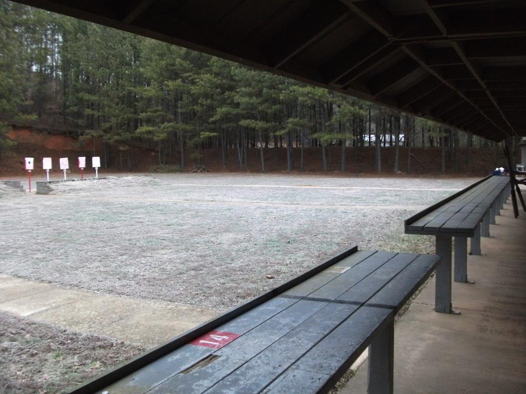

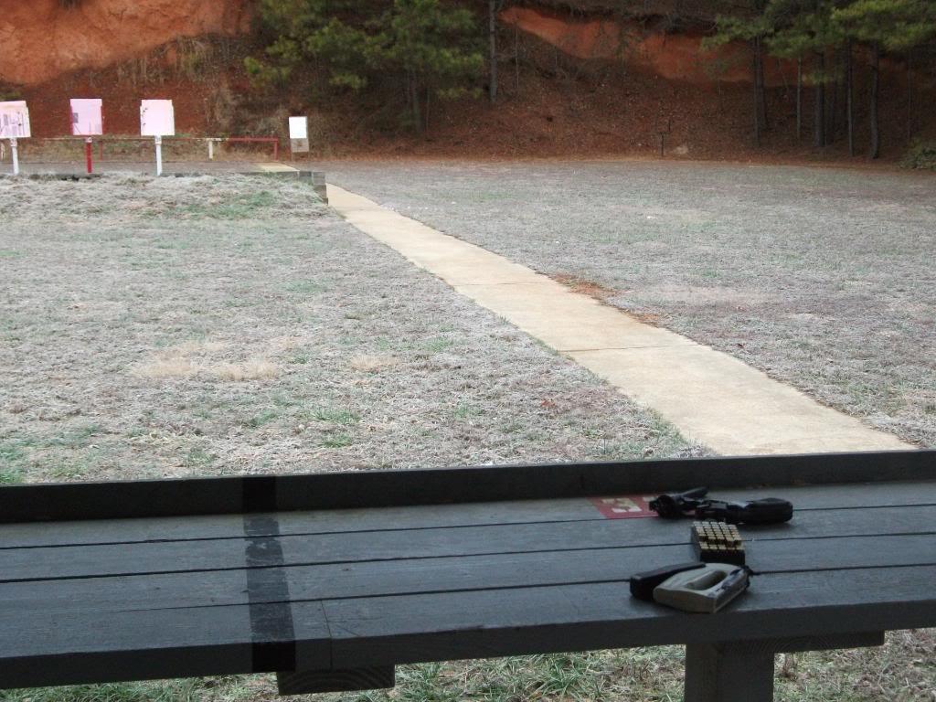

    Got to do a function test! The operator's accuracy level is well off, but tests were done at 25 and 50 yards, regardless. Need new glasse and a lot more trigger time to see if the extra effort is really worth it.

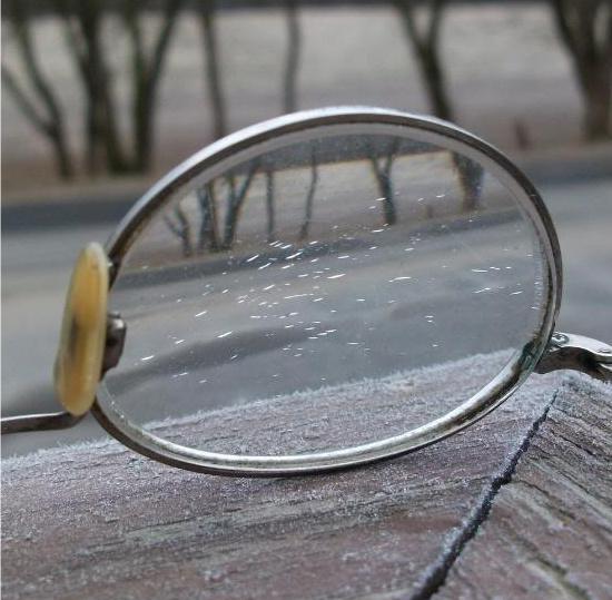

    Time for new glasses? Lens are starting to "craze".
    25 (left) and 50 yd (right) targets
    Steel Challenge DA only Model 17 used for base line shooting- Definitely off my game!
    The barely retained Remington cased ammo worked OK, even when shot out of the S&W Terrier- bullets did not jump their crimp enough to jepordize function. A little more crimp (which I tend to make as conservative as possible to maximize case life) should do the trick. It WAS noted, however, that the bullets from the "loose" cases hit rather lower at 50 yards. Maybe 4-6"?
    Conversely, more of the misses at 50yards occurred with the tight Winchester cases. Not conclusively worse, but 3 of the 5 misses (out of 18 rounds) were Winchester cases, and the other two were Remington cases that had been "neck" sized using .38spl/.357mag dies. If I was shooting better, it would be way easier to tell, though, as even the .22 was showing poor results. (Had to fire L/H but RIGHT eye to be consistant! Dominant eye (LH) isn't focusing properly on the front sight- note the "two group" syndrome outlined in red below:
    Typical example: Double action .22 groups at 25yds. Green-right eye, Red-left eye
    Otherwise, shooting impressions were favorable! Cases expanded properly (no soot on ODs), primers well indented and shoed NO pressure signs, recoil felt the same as regular .38S&W. No leading in the bores.

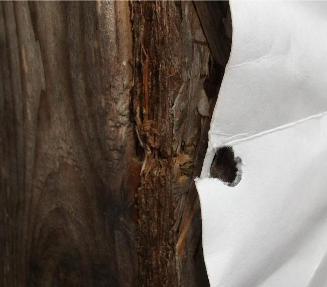

    As for power, well I'm wondering if the tales of bullets being stopped by heavy Germanicon winter clothing might not have a little merit!
    Grazing hit at 50yds into the 2x4 upright (fronted by some distressed strand boarding)
    A little digging, and- Ta-da!, a "re-usable" bullet!!!

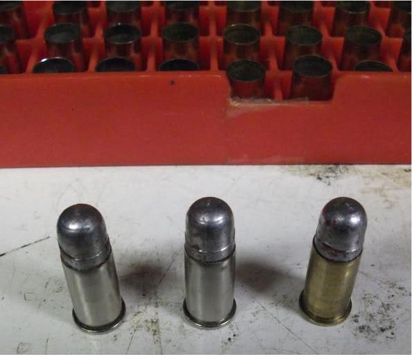

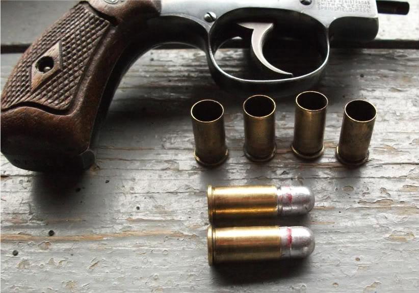

    Quote Originally Posted by chartreuse View Post
    I started some today, using Remington brass, but I found they gripped the bullet tightly with no crimp to speak of. I'm using the Lee carbide .38 S&W set.
    I notice that one of your pics shows a couple of different seating depths.
    Different dies might solve the brass thickness issue- just use whatever works best.
    The differences in length are not from seating, but from shooting! The long one is the last of a cylinder full, as described above. Bullet shifted, but not a lot.
