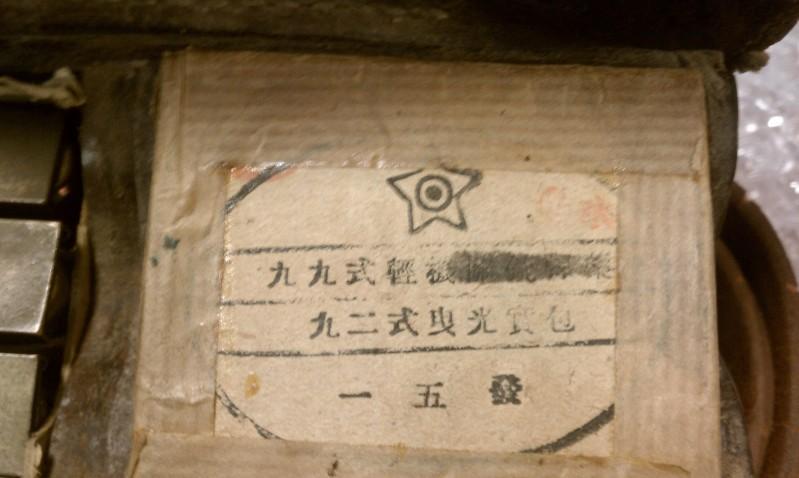

    Can Anybody translate what this box of ammo says? Received it with a 99 that I just purchased. I see similar boxes in a few books, but none that match exactly.

    Seiously, the first two characters that look vaguely like the Greek pi are 99, so you're off to a good start. As for the rest...

    9---9---type----? ---?---????
    9---2---type----light/shine-----pack
    1---5---?
    Guessing wildly
    = a 15-round pack of blank? tracer? ammo?????
    for the type 99
    Now someone ese can have a try!

    In the first picture,
    Type 99 Light Machine Gun ??(can't read)
    Type 92 Tracer Live Ammo
    Fifteen rounds

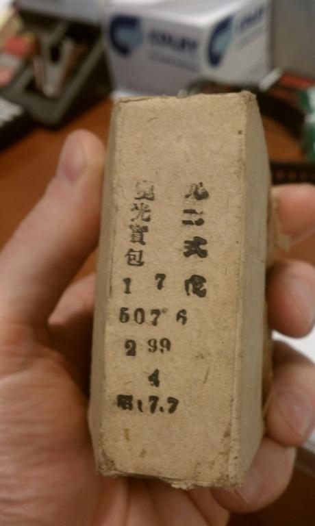

    In the second Picture
    17 ?()can't read
    Numerals
    Showa 17 (1942) July

    Hello! Here is Accurifle.
    This says:
    Type 99 Light Machine Gun Ammunition
    Type 99 Normal Live Ammo
    Fifteen rounds
