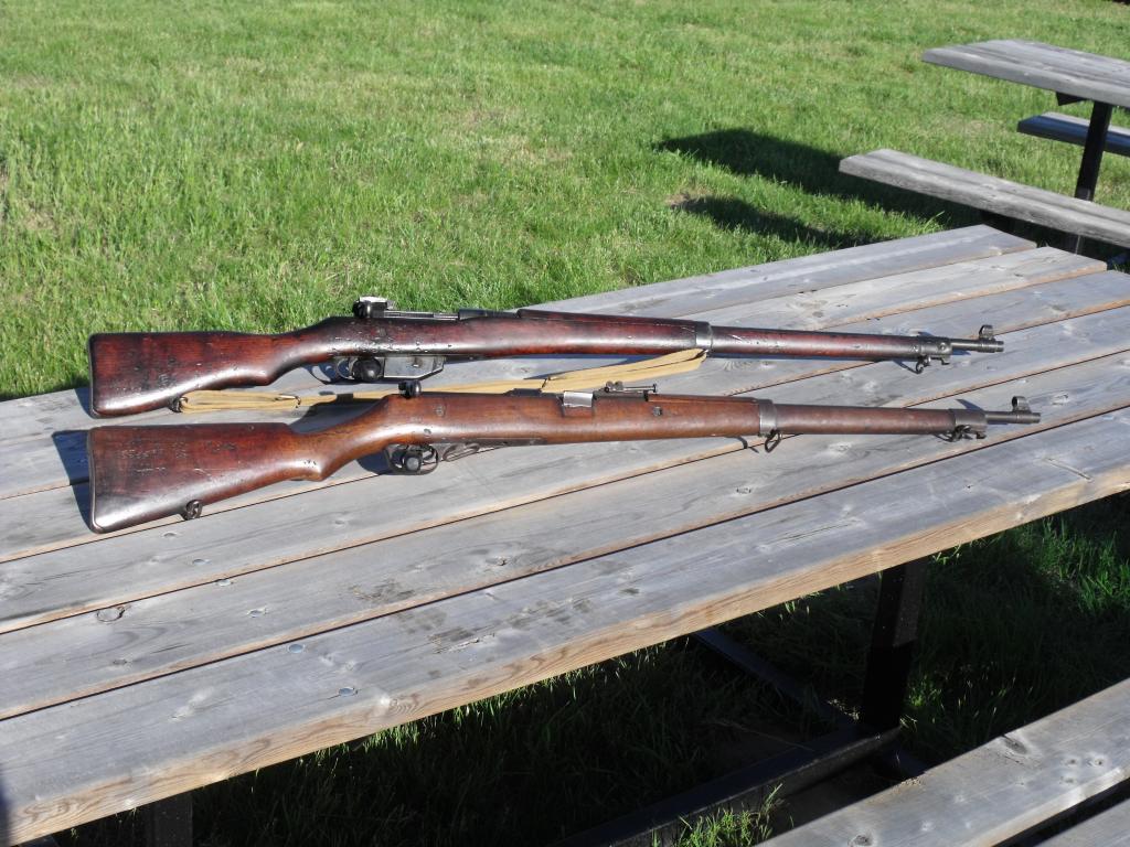

    We have here right now a very interesting 1905 Ross Rifle. We have been working on this little "project" for over two years now, and our projected (and hoped for date) was April 2012. Unfortunately shipping delays precluded this.
    However, the rifle is now here in Manitoba, and SMELLIE and I did a bit of test firing with some accuracy loads. It performs as we expect a Ross to shoot.
    Right now, we are trying to set something up, probably for mid-November, so we have a few months to work on it. A few Members of this Forum, (including BADGER naturally) have been kept aware of our progress, and I thank them for their help and encouragement.
    Just to tempt you, here are a couple of pictures. SMELLIE on the left with 1910 HMS Canadaicon Ross --BUFFDOG on the right with 1905 Ross.
