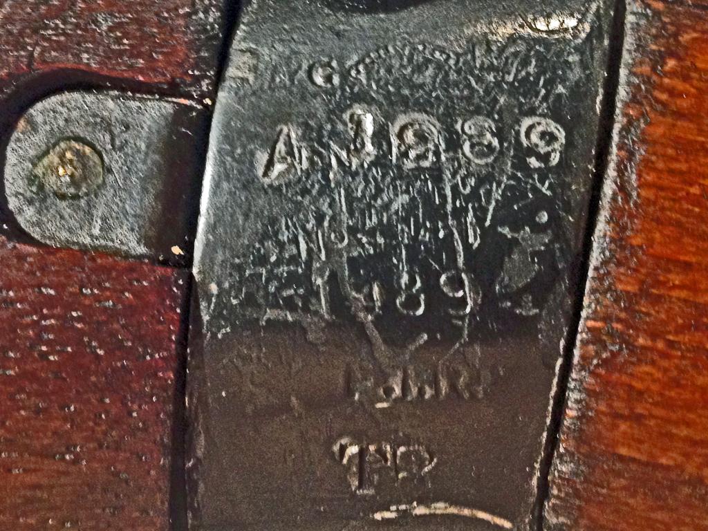

    "bros" asked "do they ever "FTR" stamp a T? "
    Yes, they did mark some No.4 MK. I (T) rifles with F.T.R.
    My 1931 Enfield Trials No. 4 MK. I serial number "A 1989" was converted at Enfield in 1941-1942 into a No. 4 Mk. I (T). "A 1989" served long and hard. She remained in service until at least 1963, according to the Britishicon Army labels numbered to both the rifle and scope. This rifle went through a Factory Thorough Repair (F.T.R.), likely in 1945 or after that. She is "F.T.R." stamped on the left side of the body socket, just above the "TR". The barrel is dated 1945 and the rifle was matched in-service with scope No. 32 MK. 3 serial number 25455.
    Please ignore the odd colouring. I played with the photo in Photoshop to try to bring up the markings.
