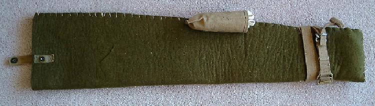

    The rifle cases, assuming that is what they are, look like hand stitched packing felt...Look at the crude stitching up the length of the case or ???
    Did they cut the stitching or did it just rip out like a feed sack or ???
    Interesting and first time I have noticed that method of packing what we are assuming to be a rifle.

    Quote Originally Posted by Warren View Post
    The rifle cases
    If you look closely at the bottom on the one para's foot, you see a snap. I'll bet they slid the weapon in from the end and had a snap fastener.

    Warren, sorry forgot your question. All our weapons bags are made with the same tough but soft felt when carrying weapons of this ilk. They were retained and reused everytime not disgarded.
    Had one of those cases previously: there was a piece of white nylon strapping similar to a heavy mine tape and a slit in the felt about where the receiver would be when the rifle was in the case. My assumption was the strap was let in through the slit and put around the rifle action (perhaps through the trigger guard). Seem to recall the rifle was to be lowered before hitting the ground, probably to avoid it entangling or striking the soldier as he landed. End closure as a simple web strap with a snap IIRC. Will see if I have photos of it still.
    ...And here's a photo I found. Looking at the photo I was mistaken above: the strap must have gone around the wrist of the butt. A No.4(T) would not have fit with the scope mounted.
    As for the removable butts on the No.5s, perhaps they were intended for other purposes - weren't the cut down No.1 Mk.V rifles with special stock bolts in TBS described as being done for South Africa police use?
