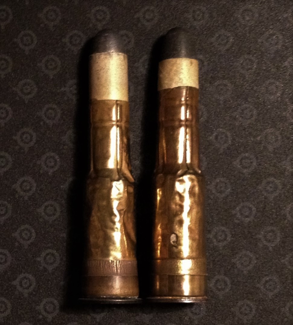

    The rolled case on the Rt RCS does it have an inspection window for checking the inner roll if it has this window then it is a Kynoch cartridge as only they had them.
    Heres a pic of a couple I have the Kynoch is on the Rt as you can see the inspection window.
    Pic quality is a bit sad an I-phone 4 I may get a better one with my new phones camera.
    I remember the first one of those I saw, wondered why they had a hole...

    Quote Originally Posted by RASelkirk View Post
    Those cases look like someone used them to "bite down
    They made them with a wrap method where they crunched the case around the load and bullet complete. I'd have like to see their machines.

    Bit like roll your own cigarette......
