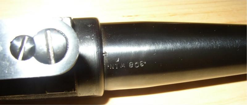

    The barreled Mauser action turned out to be pretty nice too--It is a converted military action. I was a little leery of it, because it was so highly polished and blued, that I couldn't tell the make, but was finally able to make out the manufacturer on the rail--FN
    It has a Timney trigger and what looks like a Timney low safety. The turn down on the military bolt is one of the nicest jobs I've seen. It has been D&T'd.
    I can't identify the barrel, but it is a 6 groove, 24" barrel measuring .650" at the bore, 1.22" at the receiver end and .975" at the end of the chamber taper. It seems like a "heavy sporter" or a "light varmint" contour.

    As I recall, FN made some Mauser military rifles in the 1950's that were chambered (or re-barreled) for 7.62 mm NATO (.308 Win). One of the alterations was notching the rear of the receiver ring to clear the bullet point. You appear to have one of those.
    Some of the FN rifles ended up in the hands of the Israelies.

    I received a .308 field gauge today and checked the headspace. The bolt would not close, so it appears good to shoot.
    I also ordered an inexpensive Butler Creek Mauser stock to put this in and will add some optics. I'll post a range report as soon as I can.
