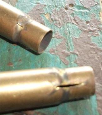

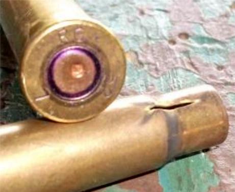

    Quote Originally Posted by muffett.2008 View Post
    Nothing wrong with the brit. cases...
    You mean like these fine once fired examples?
    Radway Green Mk.VII .303" SAA 1952.
    Y'all must have left all the dog vomit ammo over here. And NO primers.
