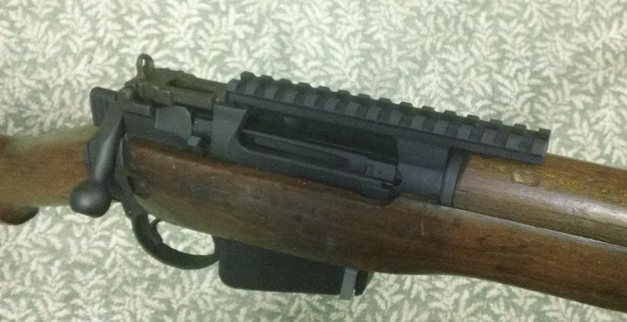

    My #4 is sporting an ATI clamp-on scope mount currently. It's... okay. But this scope mount caught my eye at some point. I like that it's low and far enough forward that the nice vernier sight can be retained. It definitely does require "gunsmithing" unlike most modern non-"T" scope mounts. It's the best I've seen, just judging by this pic.
    I've conversed with the owner of this company. He says just two holes are needed, at the forward end; for 6-48 screws. The aft end of the mount uses some kind of clamping mechanism at the charger bridge.
    Full disclosure, I have not purchased one yet, but I asked two gunsmiths about doing the job. Neither seemed keen to do it. Said one of them, "Surfaced hardened receivers mean carbide bits and broken taps".
    Since SIA is/was known for doing a lot of LE #4 conversions of one type or another, I figured I'd ask Richard, the owner, about the difficulty in working with the receiver. He said he doesn't find the #4's steel to be particularly hard: "I've never seen a "hard" Enfield action. That is a common Mauser issue."

    I’ve fitted them,it’s no drama. The receiver ring is soft and drills very easily.
    It’s a very solid mount, as low a possible and the rear locking wedge is very strong and solid. On one that I fitted I had to shim the wedge, but that was easy and just .010 shim stock.
    Like you, it’s the best I’ve seen. The length of the pic rail is ideal and the strength and solidity of the unit is exactly what it should be.

    Thanks for the confirmation Tbone. I'm amazed these mounts have not gotten more notice. Do you remember if it's steel or aluminum? I'd think aluminum due to the bulk.
    Richard emailed me the installation instructions earlier in the week, just to answer a few questions I had. Only the text, no illustrations unfortunately. It describes this wedge and mentions that some actions may require shimming, others possibly require careful removing of metal from rear edge of the wedge---with a caution not to alter the wedge's 5° angle if metal removal is required.
