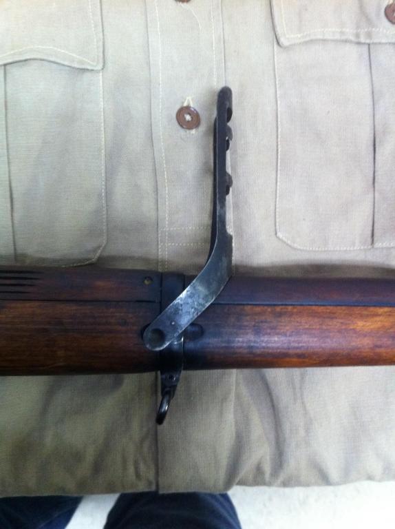

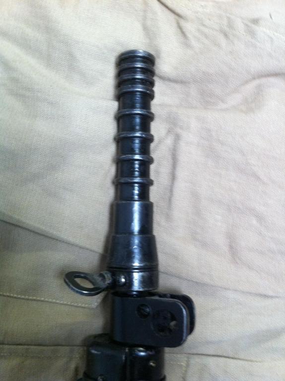

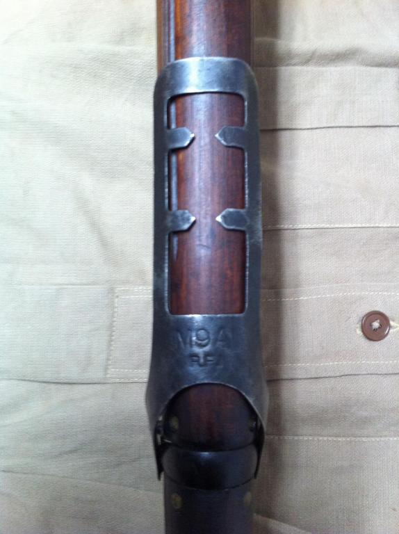

    And to add to the confusion, the fore-end and band are from an Indian grenade launching rifle. Like this one.
    The markings have also been linished off the body and buttsocket.

    Insufficient data. Photo of whole rifle, and then all numbers and markings on metal and wood possibly remaining, eg on bolt, butt, fore end, would help to answer the question. They couldn't have removed every single one hopefully, especially on the wood.
    From the two photos there is only one conclusion, a grenade launching LE modernised in India.

    The rifle was certainly issued in India as can be seen from the screw, from the asterisk on the action ring and from the slots for the grenade launcher (as well as the stamp with the Indian depot).

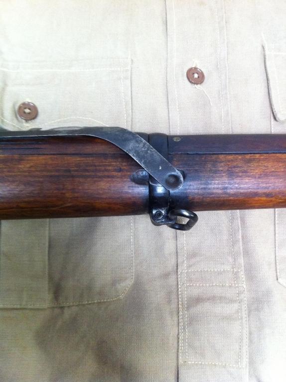

    Yes, a Mk2 is easy to spot from the cross bolt rather than the cross strap on the back of the forend.
