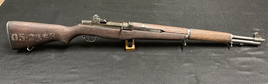

    question on cleaning
    Charlie,
    I know I'm replaying to a very old post but I've got a question. How aggressive is this cleaning process? I ask because I would like to try it on a rifle but don't want to remove the used by the Armory to number the stock.
    Just curious about how careful I would need to be around the edges of the paint.
    Thanks
    Bill

    On the markings you want to remove be sure to tape a tight line along the outside border to keep any dissolved paint from seeping under in to grain beyond border lines of the letters / numbers.
    Charlie, I think you misunderstood. I want to keep the painted-on numbers (see picture) and was wondering if the Natural Turpentine would dissolve the paint so I could figure out the best way to protect the paint when using your cleaning process. As you can see in the picture the painted numbers are worn so I was hoping to client the stock to include the areas in and around the numbers. I use Citrus Solvent cut with polymerized RLO currently to clean my stocks, which is a lot of time and elbow grease; purposely, though rather slow and safe than a ah-crap.
    Thanks again
    Bill

    Quote Originally Posted by usabaker View Post
    Yea, I blew that one. For some reason I pictured maybe some Korean markings you wanted to get rid of and the GI markings you wanted to save.
    Not knowing what type paint was used and seeing how thin it is has we worried. Any type of Turpentine will thin oil base paints and will dissolve them. Turps can be used to wrinkle up dried water based paints also.
    My current thought would be to seal the numbers 1st thing. I'd coat the numbers using a artist brush with a Tung Oil in a Sheen that would match your final stock finish. Then you'd be able to detail clean inside the numbers (carefully).
    It's about the only option I can think of to protect the painted numbers.
    If I come up with something else I'll post.
    Charlie-Painter777
