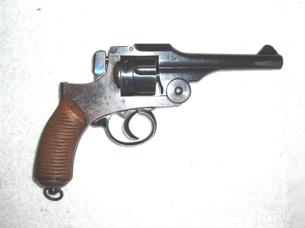

    Jap Type 26 Nambu Revolver 9x22
    Images of this rearsenaled Japaneseicon pistol. Made ca. 1893 and redone ca. 1934. Spirals on grips means rearsenaled plus other items. Obsolete cartridge.
    Sorry for the number of images but one does not see these this often and in this condition. Marine bring back from Pacific.
    This says, 2 10 6 year type. Type 26 Tokyo/Kokura Arsenal

    The indent is for opening the side plate to clean action. You must first pull the trigger group down to release the lock on the indent. Somebody tried to to open the side plate without pulling the trigger group down. May not open now.
    Front of pistol...
    Compare original cart. to modern 9mm....
    Pistol is a copied mixture of other foreign firearms including S&W....

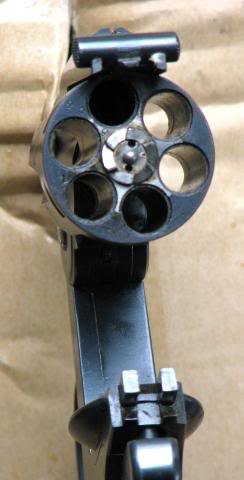

    Pistol is double action only and cylinder only locks up for firing! If cylinder is moved from outside source, you may try to fire an empty chamber! Not good!

    I have one as well. Mine has the same grips but the finish is original. Quite an interesting revolver. The thing I couldn't get past is the cylinder turning on it's own and not locking. Strange! I'm told that one can reload rounds for it using cut down .38 S&W with a light powder charge. I think I'll just leave it in the safe and look at it once in a while. Mine came with an original holster with Japaneseicon writing on the inside flap but no cleaning rod. I hear the cleaning rods are like hen's teeth and when you do find one it is rotted away.

    They are neat but they are not a Nambu as in Nambu had nothing to do with the design. The first Nambu was what we call the Grandpa Nambu and all Nambus were auto loaders. As a matter those grooved grips are original to some of the type 26 Japaneseicon revolvers but only the tail end of production they are a arsenal replacement on yours.
    You may be right. Most of my information came from here. Thanks!!

    Those grips were also replacement grips, so a revolver may have them without ever having been reworked if the original grips were damaged.
    Correct on the "Nambu"; Nambu had nothing to do with the Type 26, but Rast and Gasser did, as did Smith and Wesson.

    Here is mine. It has some engraving on the frame and barrel/cylinder assembly F3-499. I'm told the color of the hammer tell of it's original finish.
