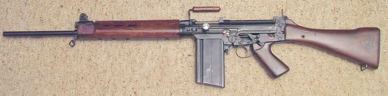

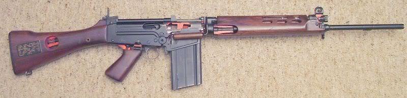

    X8E1 Trials Rifle
    Here's a converted X8E5 to a L26A1 Sectionalised Rifle
    Good luck in trying to rebuild the rifle back to the way it was, there are american's that try building 'Clones' and it costs them $1000's.
