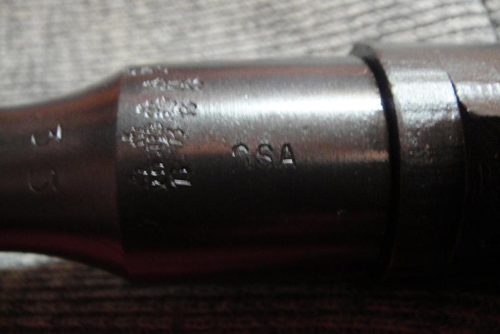

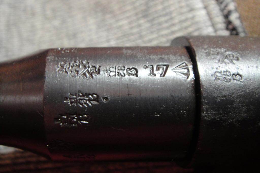

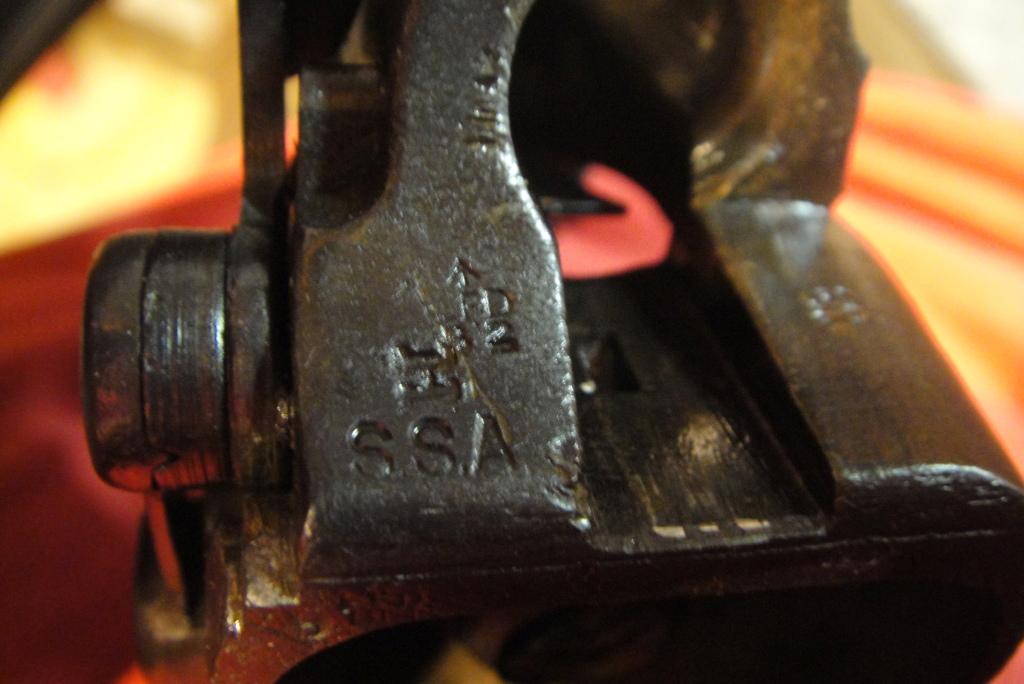

    I recently picked up a cosmo blob that resembled a rifle. I started cleaning it up and found a nice 1917 SSA with original 1917 barrel. On the bottom of the barrel is stamped SSA. I was under the impression that SSA didn't make barrels only bolts and receivers. Is my limited knowledge wrong?

    Hi
    Alan de Enfield wrote a very good summary about Standard Small Arms (which is available in the archives). His post states that the SSA factory was instructed to produce four items; body with charger guide, bolt, bolt head and trigger guard.
    I have a 1917 dated SSA too and the barrel is stamped the same as yours. However, the inspection stamps on it are all BSA (italic B), so I assumed a BSA made barrel that had been assembled perhaps by SSA. My rifle also has a SSA stamped trigger guard - which is what first drew me to it, for a closer look, when I saw it standing in a 'for sale' rack.

    So, what are we saying here--does this mean that Standard Small Arms were doing the breeching up then sending the barrelled receivers on for final assembly into complete rifles at BSA or RSAF Enfield, viz stocking up, regulation of sights, etc? Interestingly, I am given to understand RSAF Enfield did exactly the same thing to expedite SMLE III/III* Dispersal production during WWII. So there would seem to be a precedent for such production pioneered during WWI under the Peddle Scheme. I have always been given to understand that SSA sent the finished receivers to either RSAF or BSA. It had never occured to me that SSA was sending barrelled actions! Makes sense when you think about it! My 1916 SSA III has a '16 dated LSA made barrel with Peddle scheme maker rear sight base but all other components are RSAF Enfield manufacture including the stocks and the rifle received its final inspection at RSAF. I have no 'SSA' marking on the bottom of my barrel, however.

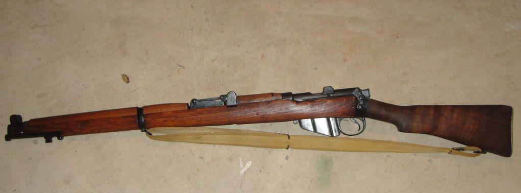

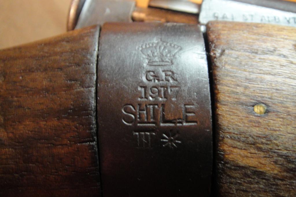

    Thanks for the info, you learn something on this site every day. here are some pics of her all cleaned up. Off to the range I go to see if it shoots as good as it looks.
