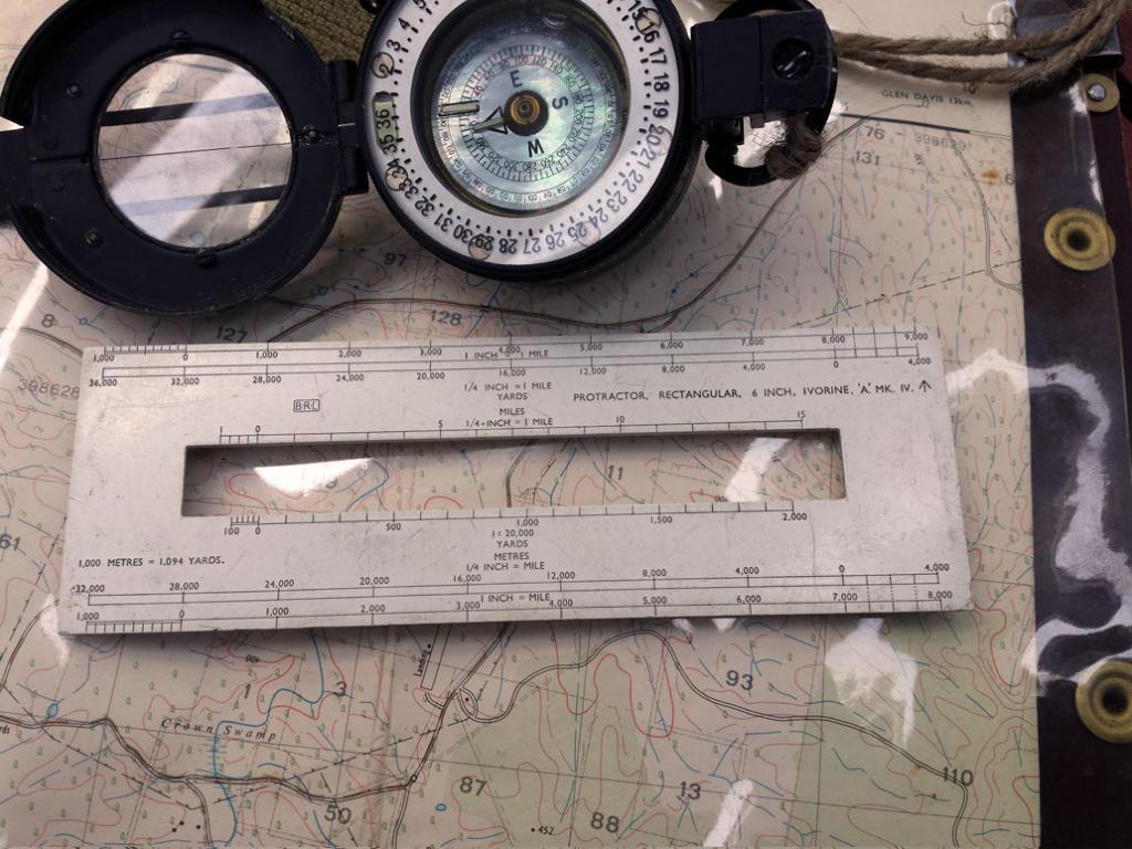

    I found a photo of my compass with its post-air travel bubble -

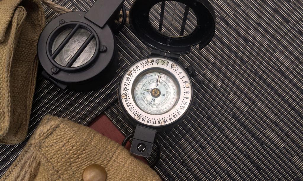

    And one I just took showing the mysteriously absent bubble after the sunny window sill procedure -
