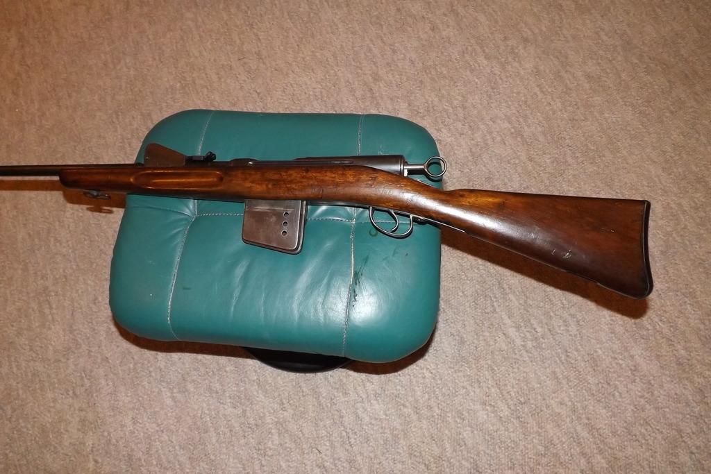

    Yes, the company who did the conversion cut the stocks just behind the rear barrel band. I don't know the name of the company in Canadaicon that did the conversions.It still has the original sights. I came across an old advertisement that listed the Schmidt Rubin 30-30 conversion for $29.95. Kind of surprising as I believe an Enfield sporter could be had for less.
    Anyhow, I removed the varnish or whatever it was. I think it was just applied over the original finish because once I removed it the rifle looked a whole lot better. So much so that I am just going to give it a couple of coats of BLOicon and leave it at that. I'm not trying to make it look like a new rifle and this way the overall look of the rifle will match.

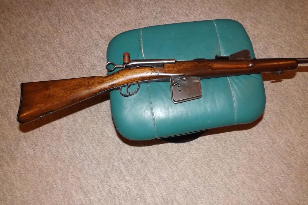

    Here are a couple of after pics. As mentioned, I didn't want to take it to the point of looking like a new rifle. So I just removed the coat of varnish that had been applied. That's where the majority of scratches/scuffs were. All I did was apply a couple of coats of BLOicon. I think I achieved the look I set out to do and it looks a whole lot better with not that much work.

    great looking rifle now may not be high collector in todays market but in 50 years who knows might be a gem,. now show us how she shoots good job enjoy

    Thanks. I got the mag working. I just wasn't pushing sideways hard enough on the thumb press. I'll be opening the cabin up in another month or so. Then I'll see how it "performs" as I have a lot of "shooting range" out there.

    Much better! Nice work.
