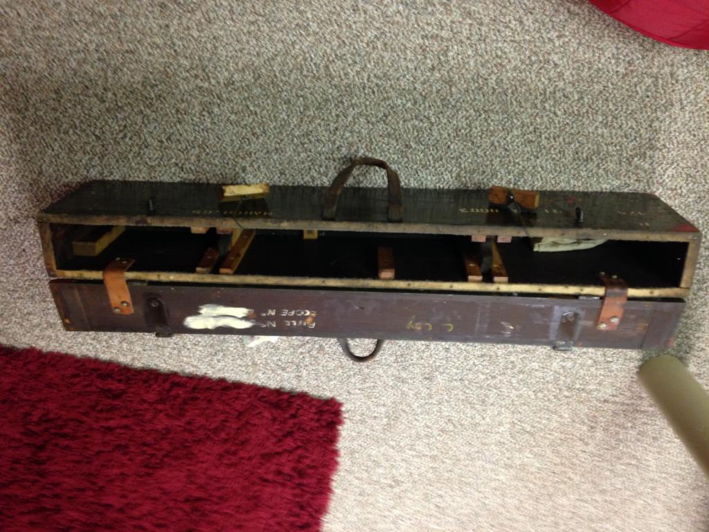

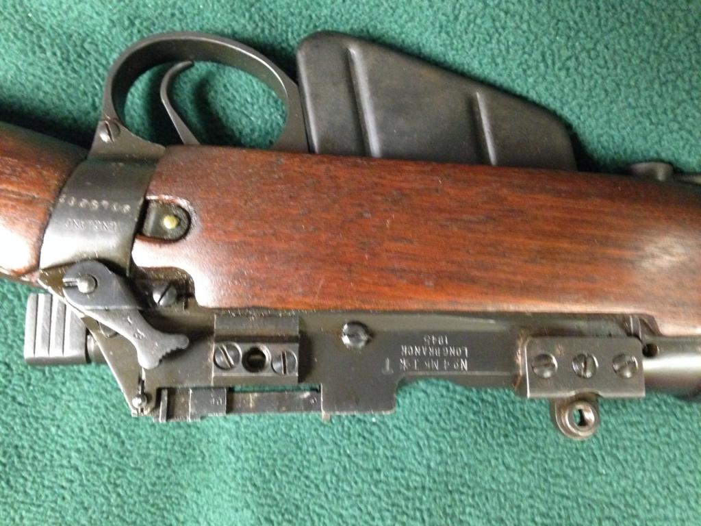

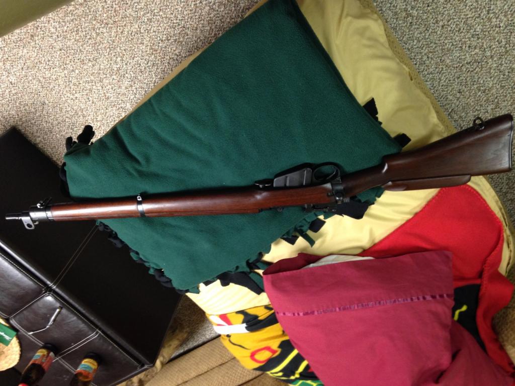

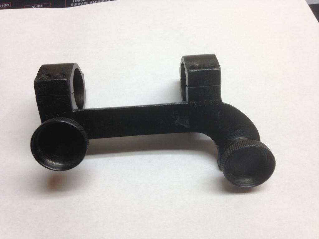

    Gentlemen,
    I have acquired a VERY nice 1945 Long branch No. 4T with transit case and mount. Unfortunately it does not have a scope with it.
    what would be the proper scope for the rifle?
    I have a possible lead on a No. 32 MkI but the cosmetic finish is very rough. The seller says the drums move freely and the glass and reticle are in good shape.
    would it be worth picking up the MKI even if it is not the correct scope?
    All opinions are welcomed
    -Nick

    Hello Nick, congratulations on the Long Branch T.
    The serial block (first 3 numbers) of your rifle will tell us whether the originally proper scope was a C.No32MkII or a C.No32Mk3.

    the number is 90L821x
    the optic in question is a MKI, which I guess would not be correct.
    pictures can be found here: http://mbd.scout.com/mb.aspx?s=541&f=5516&t=13877319

    The proper scope for your rifle would be an REL manufactured C.No32Mk3

    Is the REL scope number stamped on the wrist of the Rifle?
    Add the Rifle to the list if not already there .... you never know, sometimes lightning does strike.
