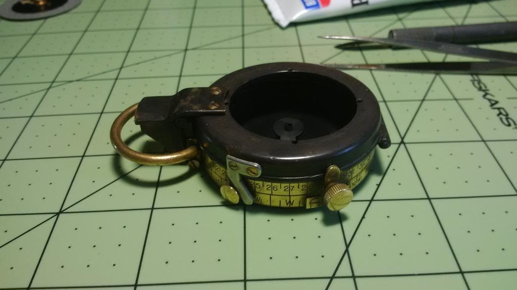

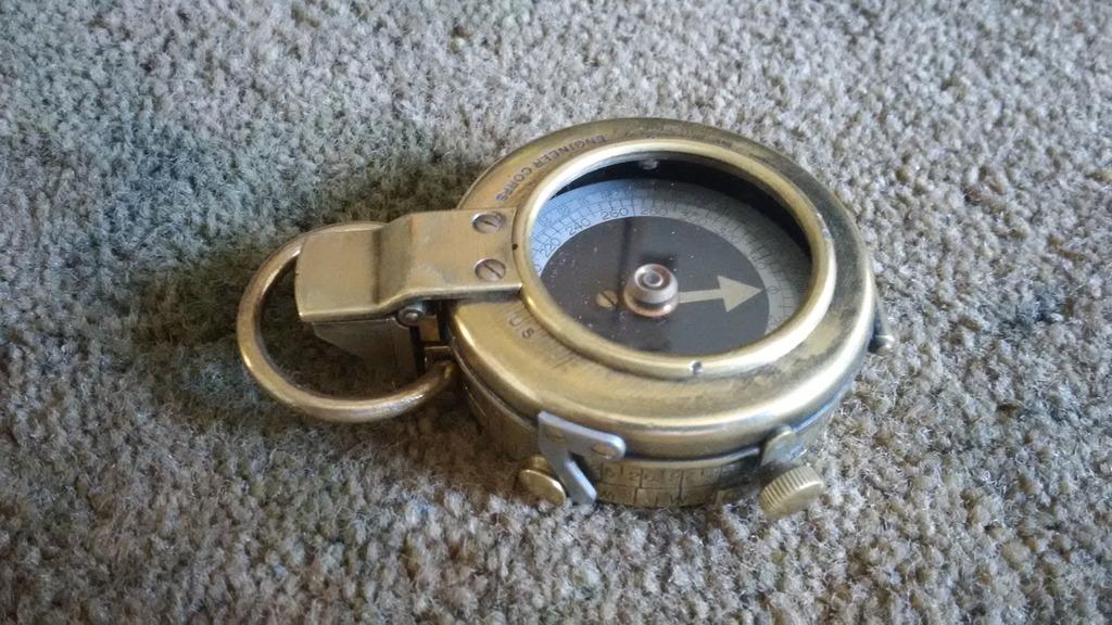

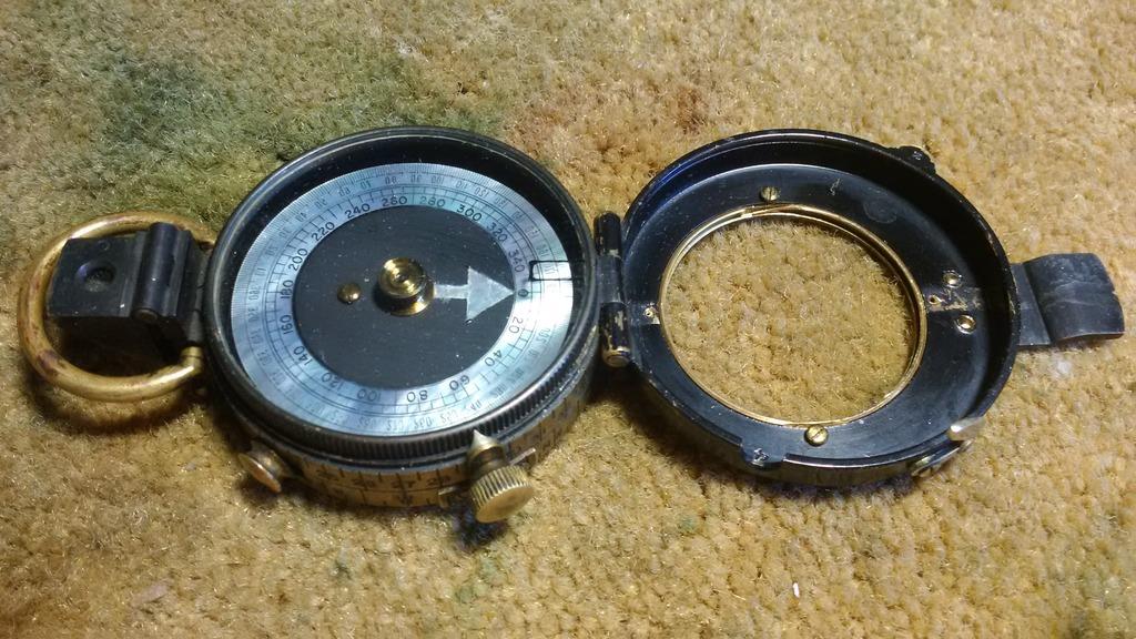

    After lurking around here for a while, I was bitten by the prismatic compass bug. As a way of introductions, I am presenting my humble effort at resorting one of these:
    It is a U.S. Engineer Corps compass marked CE and dated 1918. The finish is worn and the top glass is missing. After checking it with my geiger counter (AN/PDR-27S) and removing all traces of the radium, I was ready to start.

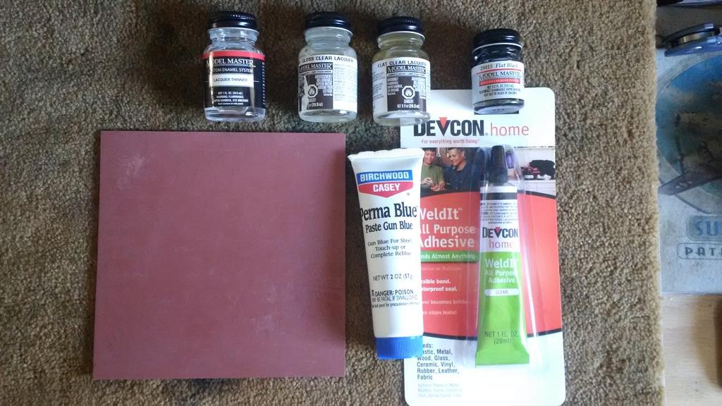

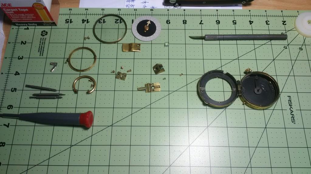

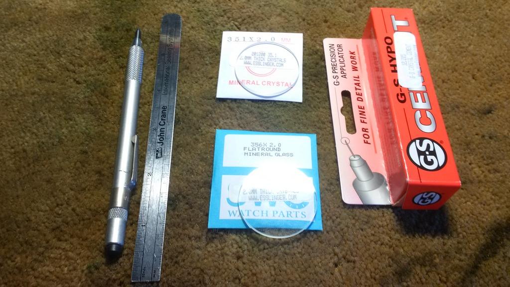

    Here is some of the materials I will be using:

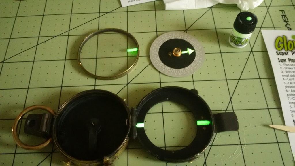

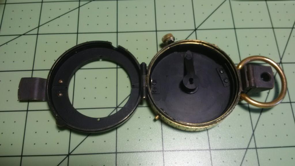

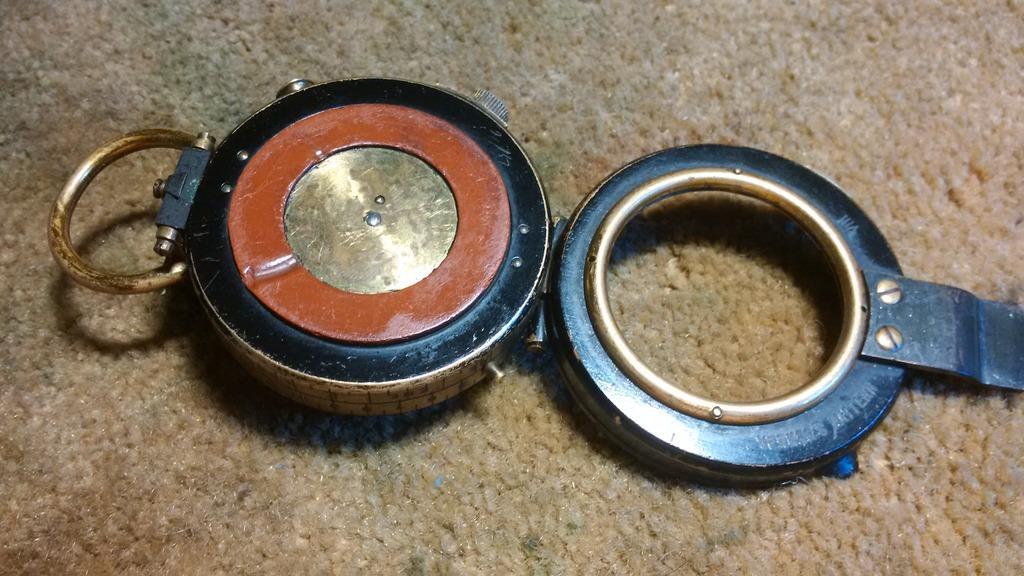

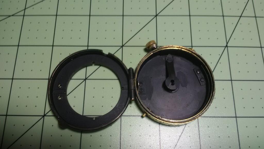

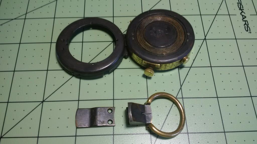

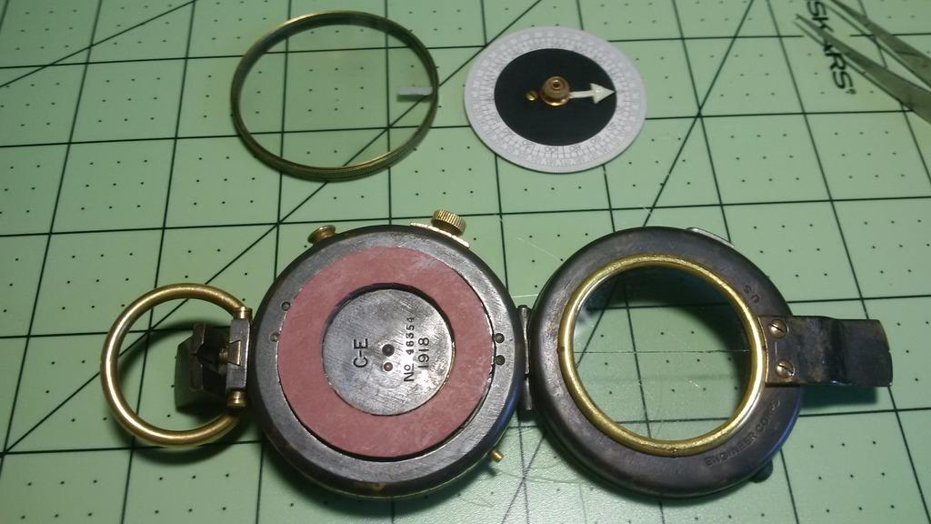

    We begin with a complete strip down:

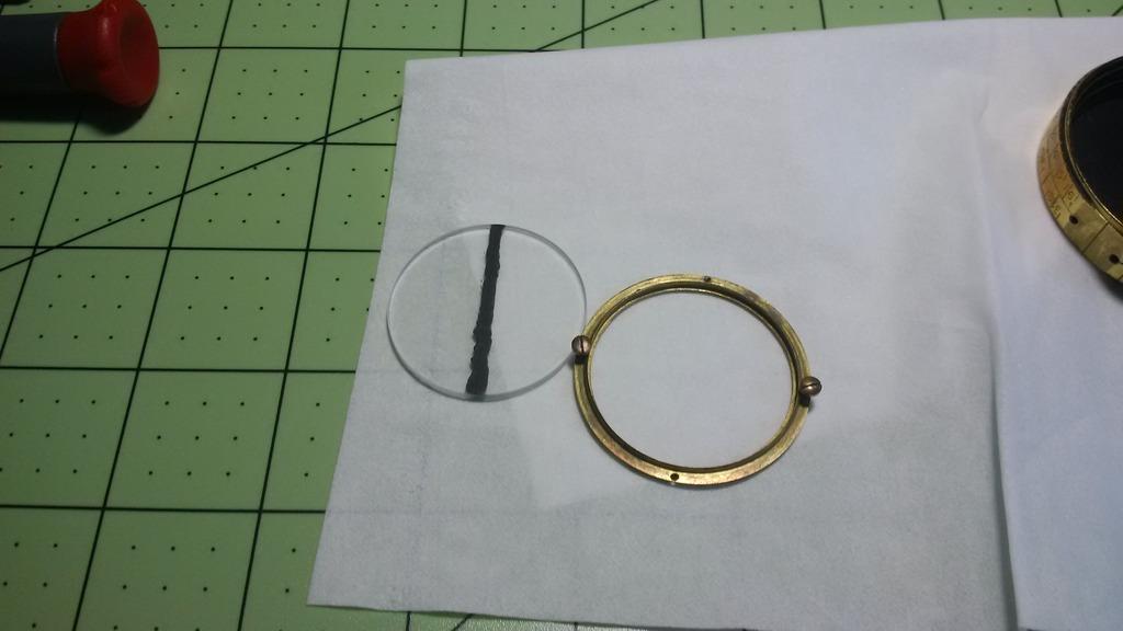

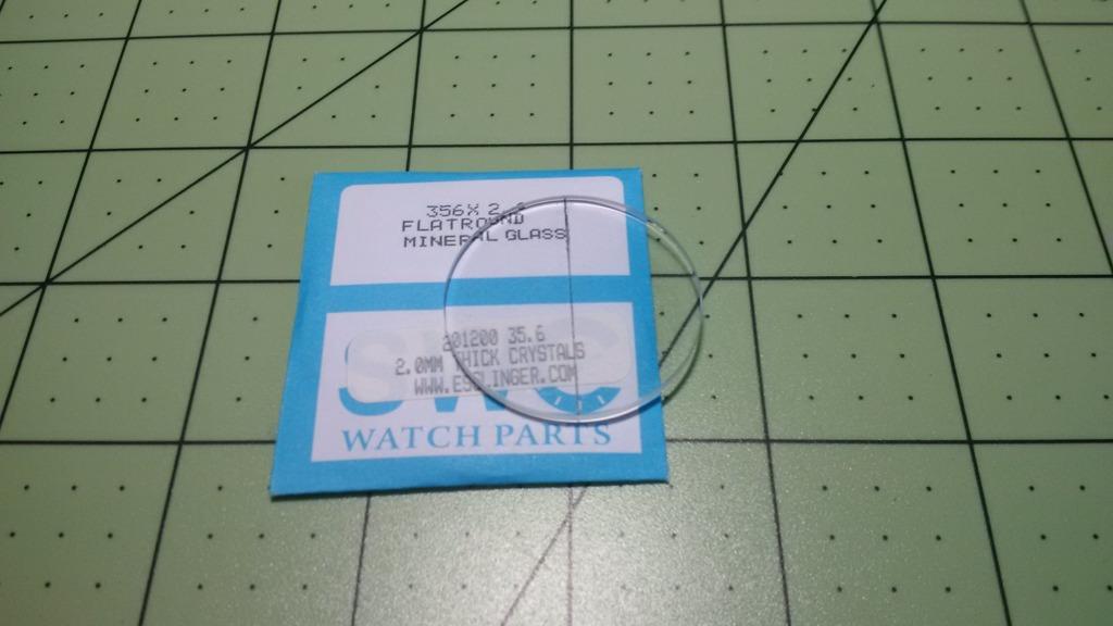

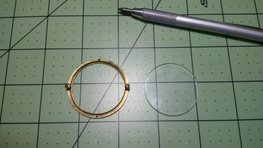

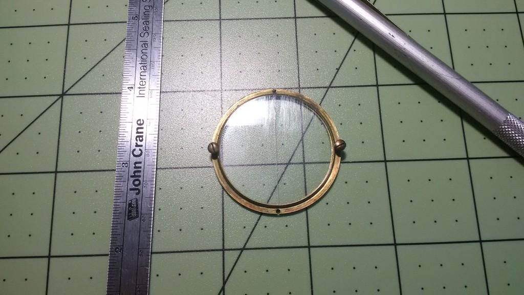

    Etching the sighting line on the new glass (size 35.6mm x 2mm thick):

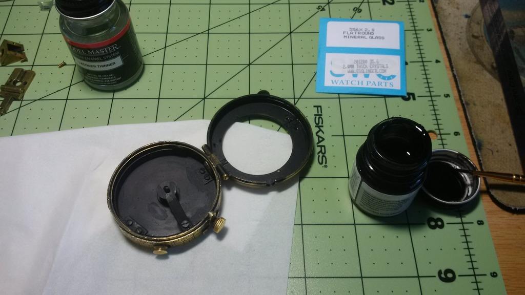

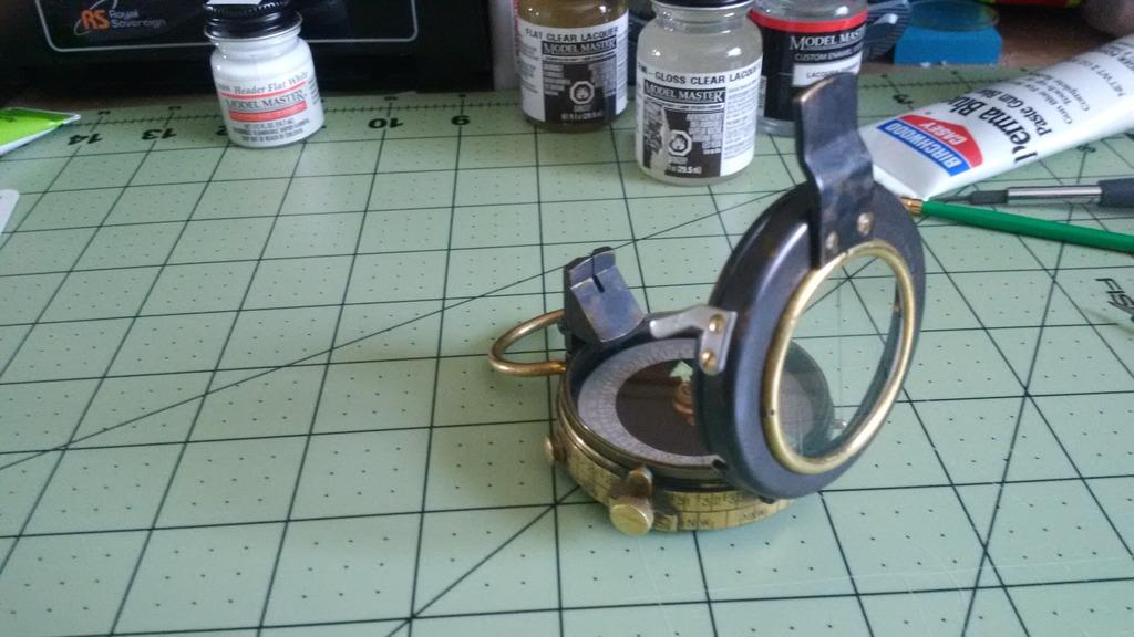

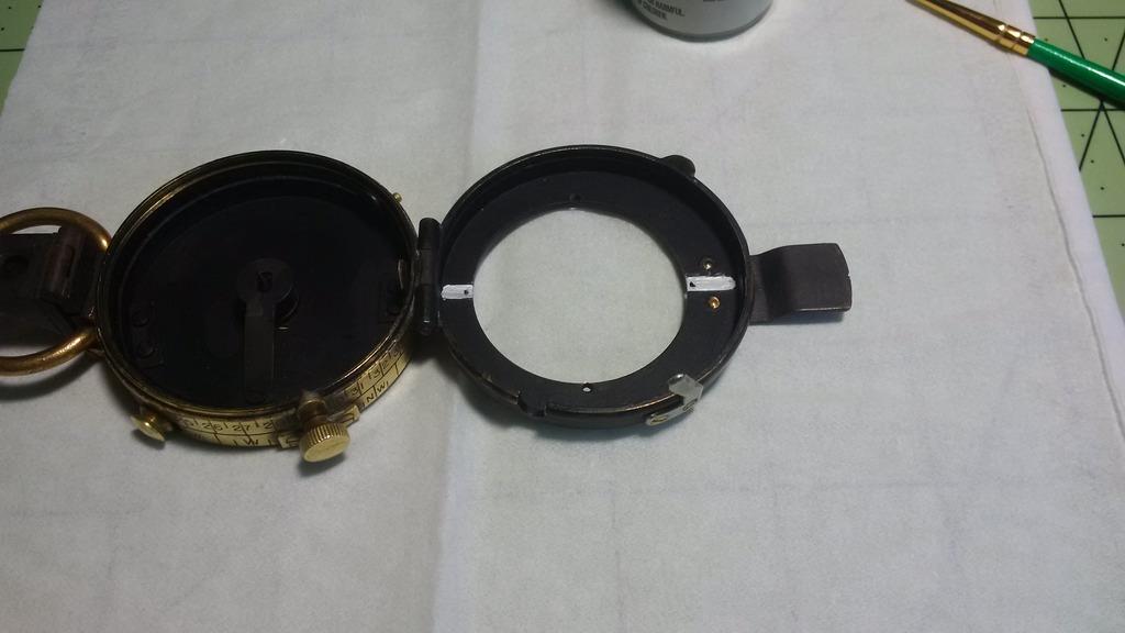

    Touching up the flat black interior with laquer:

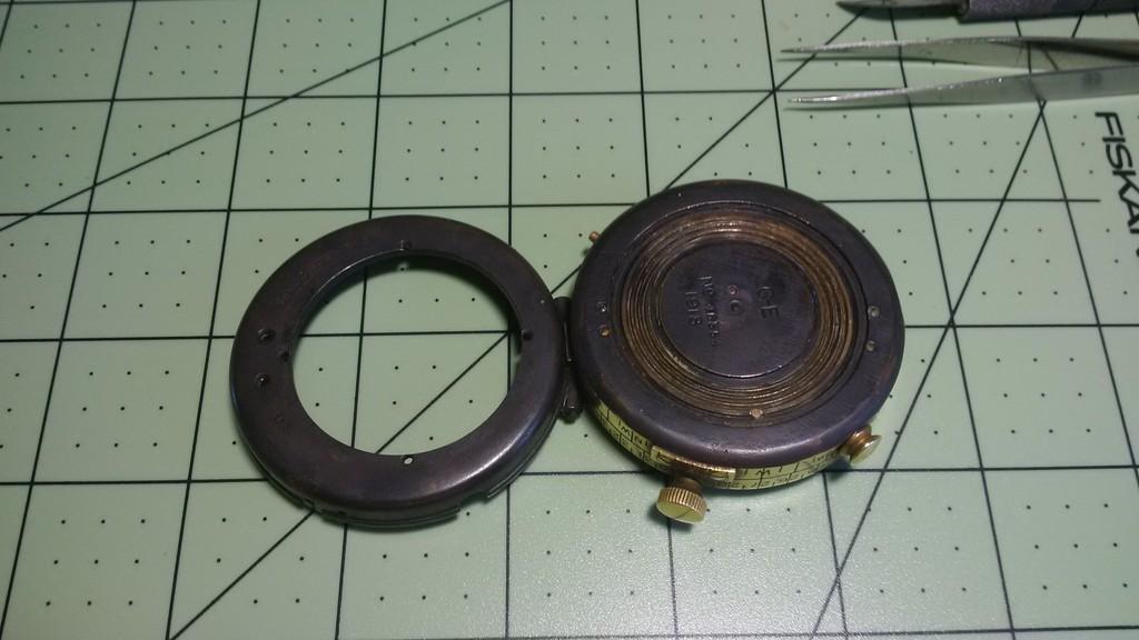

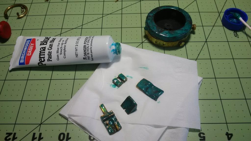

    Blackening the brass in the appropriate places (using paste gun blue):
    Here it is blackened and ready for reassembly:

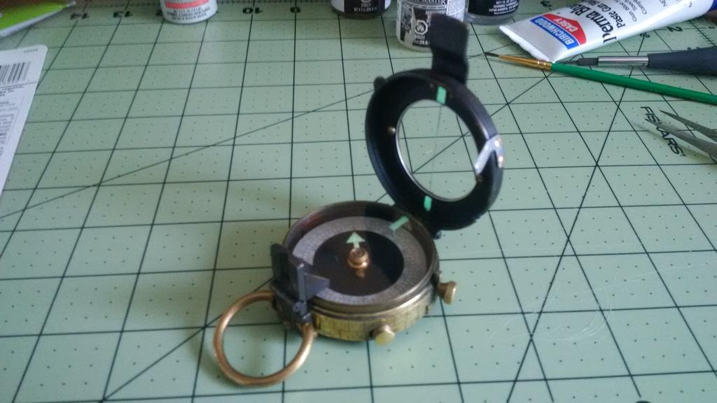

    Reassembly:

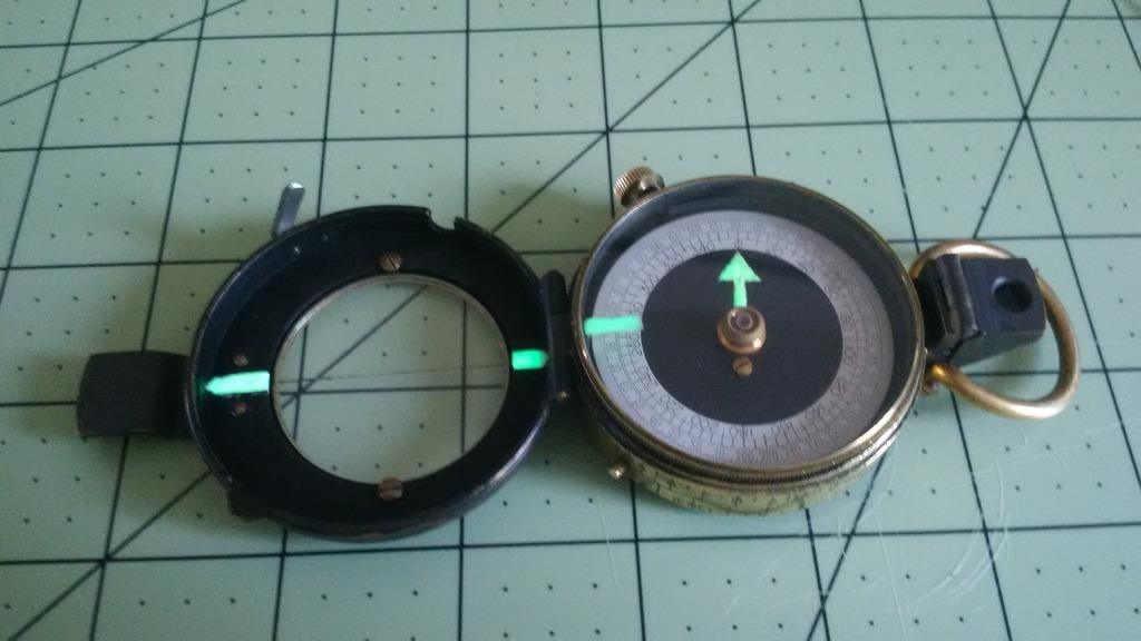

    Applying glow in the dark paint:

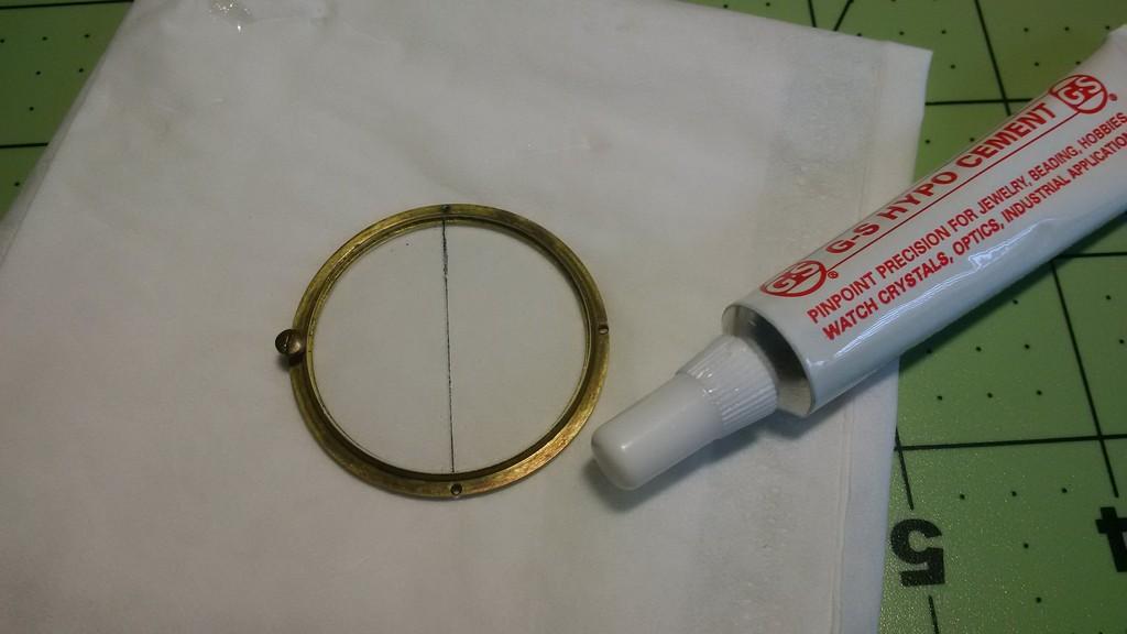

    Gluing the top glass to the bezel:

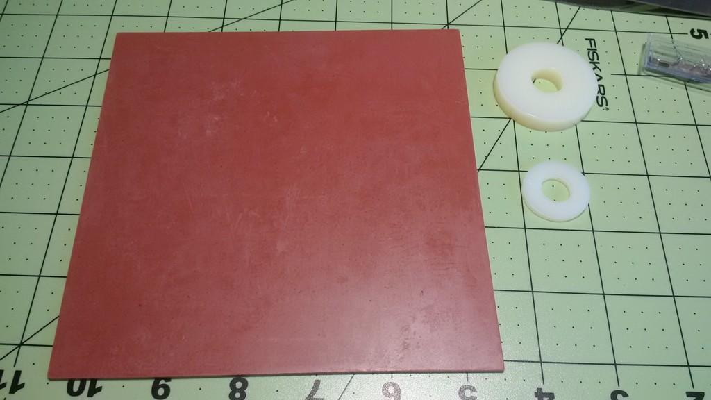

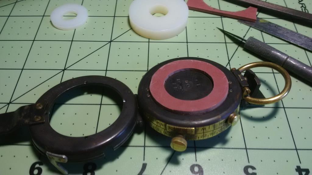

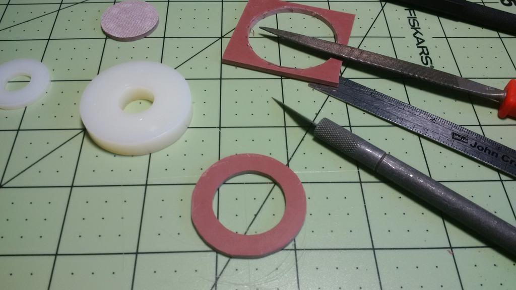

    Making the rubber friction ring (1/8" red rubber gasket material):

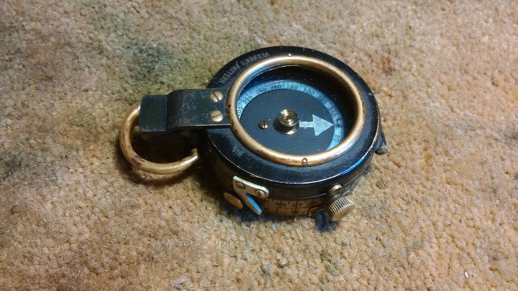

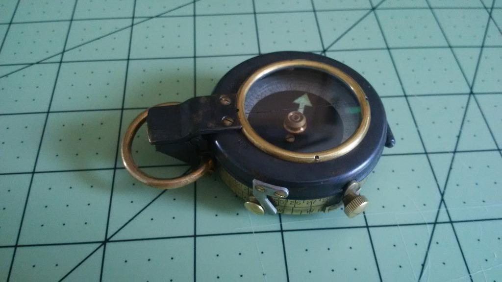

    Finished!
    It was a labor of love, I also have an English Mk VIII private purchase but all it needs is the radium cleaned out, new glow added and a replacement top glass.

    Great restoration, but I would epoxy the crystal in, G-S crystal cement is for use with plastic. Epoxy is a more permanent bond and is water resistant. G-S also make a uv crystal cement for use with glass.
    Canaris's Avatar
    Jun 2014
    11-16-2017 @ 10:01 AM
    Florida
    2
    05-06-2024
    06:35 PM
    If the crystal set doesn't hold up I have a spare and I'll look at the uv adhesive.
