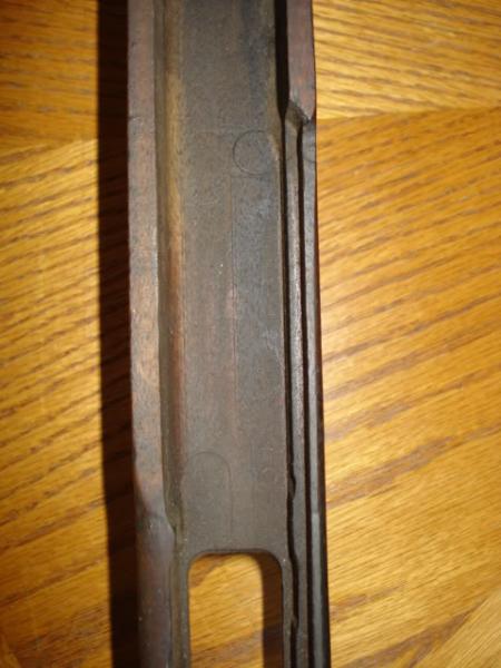

    Pictures of Winchester type III or IV stock
    Got the son's help and took a few pictures.
    What do you think.....Converted type III or short channel type IV?
    I appreciate everyones help.
    Harlan,
    I promise to take before pics of all. Before I strip and refinish.
    Charlie-painter777
    Top Views,
    Left Side Cut out,
    Right Side Cut out,
    Full Right Side,
    Full Left Side,
    Found a CC under that old Rack Paint !

    Does it have the extra recoil plate support?

    Extra Pictures
    Chris,
    I'm hoping I have the correct pictures for you.
    Only thing I can see different can be seen in this first picture on the right side. My other Hi and Lo wood stocks don't show this curved cut.
    I haven't stripped the bottom of the pistol grip yet. Other than what might be under the paint on the grip bottom, they are no Re-build stamps or stamped P proof marks.

    The right side appears to exhibit some evidence of the stock originally having the bridge of wood that normally is present in the M1icon stock. That would tend to indicate a later conversion.
