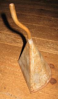

    No markings on mine belonged to a WWII armourer friend now deceased I feel it may be a home made job or at least made in the workshops as it is quite well done.
    Thank you, Cinders. Also, thanks for including the photo - your example is quite a bit different from mine. Different joints, larger rolled edge, etc. As you say, still a well made piece of kit.

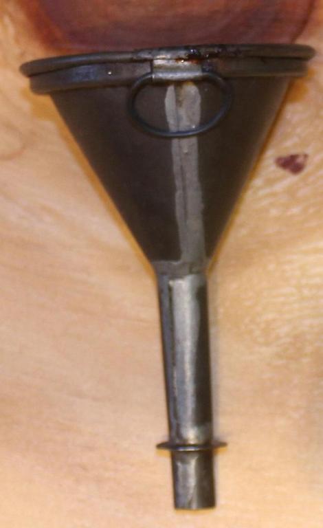

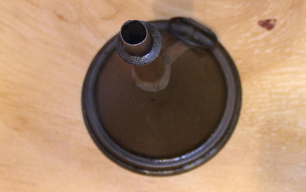

    I have two, one is I am sure as Peter described, Armourer made with a recessed ledge that sits on the charger bridge and a suitably kinked .303 case as the spout.
    The other is manufactured and dated 1944 ... Only issue is finding them!
    I will look through my gear at the weekend and photograph them.
