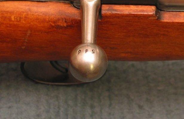

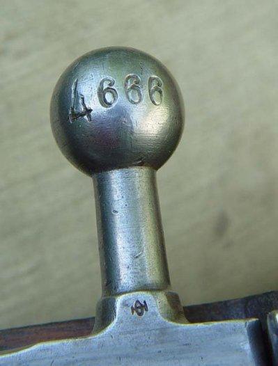

    "... but I'm really sure that the 81006 serial is marked on the round part of the bolt handle..."
    The Swedes numbered bolt knobs---
    The Finns sometimes numbered bolt knobs---
    Ishapore followed the Britishicon numbering scheme and applied serial numbers to bolts on the rear face of the bolt handle, not on the knob.
    Check the archives of this forum and you may gather information that will help you find a really original rifle.
    That is to say, a rifle that has not been altered in civilian hands after being sold out of service.
