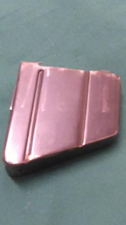

    Hi guys,
    Can anyone tell me who made this mag and when?
    Thanks in advance.
    Jon

    Not sure but could be an SMLE Mag modified to fit a No.4

    Looks like it to me also, a couple more pics would help.

    Still looks like an SMLE mag modified and then numbered to it's rifle.

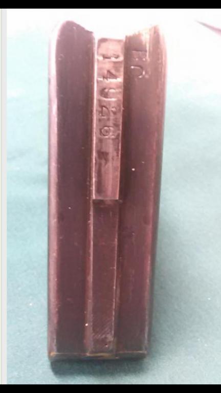

    The serial number and accompanying "BO" mark look like Indian markings. I have a 2A1 rifle that is serialed on the mag in nearly the same font.
    I agree that it's a MkIII mag modd'ed to fit a No.4.

    In 1941 a contract was issued to modify 100,000 No. 1 magazines for the No. 4.They are not uncommon to find.

    Perfect thanks fellas!

    I have one of the converted SMLE mags as my back up No4 magazine in my range bag.
    It's another interesting Enfied side story.
