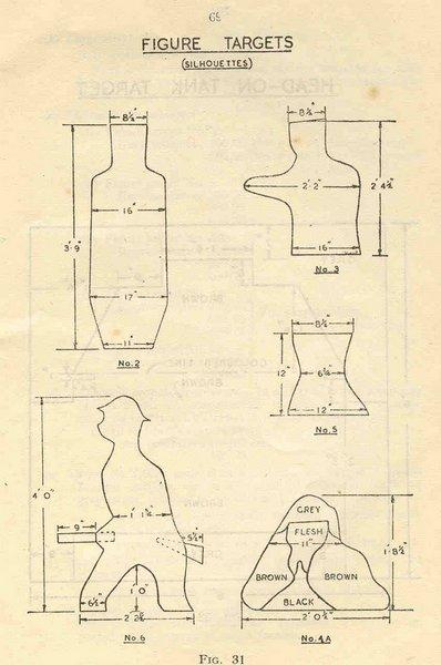

    My local club is thinking of running a SMLE competition (100yds standing, 200yds prone) and is trying to decide which target to use. Tin hat or Fig.11?
    Which would be more correct historically?
    Thanks.

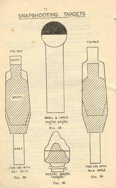

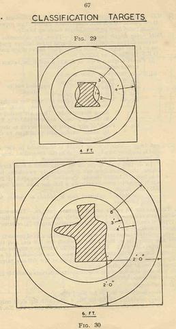

    I'd go with a Type B 4 x 4 Figure 12 Type B represents 8" (200mm) scoring ring convention. V = 6” 5 = 8” 4 = 16” 3 = 32” 2 = 48” Remainder target value is zero.
    Gives them a chance at 200 yds especially if your a tad evil and have at 200 yds for a bit of fun if you wish 10 rounds in 40 seconds with a reload starting with 1 in the spout 4 in the mag the issue starts when the reload happens yep 4 seconds per fired round sounds plenty but factor in getting the stipper in and it chops that time per shot right down its doable but you have to be very disciplined and if you get a rim over the games pretty much up.

    my thoughts would be to use one of the british figure targets. watch from the 15.00 mark.

    We'll be discussing the comp at our club meeting on Sat, I suspect we may go for tin hat - thank you Frederick303, tin hat being more historically accurate (shown in the 1910 School of Musketry pamphlet), Fig 11s were post WW2.

    Depends on the aim of the competition.
    If military, and your first outing, a larger target. Also plates as they don't have scoring lines. Also which era? SMLE were used from before WWI up to Korea IIRC.
    If for fun, a large bullseye so they don't become discouraged and don't come back. If possible, plates as they provide immediate reaction.

    Targets in use earlier before WWII were usually bullseye, I conclude from the internet, eg see the mad minute target - a bullseye with a stylised torso.

    Quote Originally Posted by newcastle View Post
    Anyone have a source or name (so i can look) for the targets in Cinders post??
    Google Sykes McQueens Targets, I'm about to buy some of the smallbore versions for myself.
