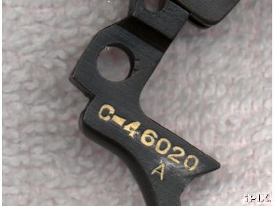

    Amola
    The trigger on Gas Trap 7114 in the Royal Small Arms collection in Britainicon is marked C-46020 with an A under it. Can we assume SA experimented with Amola as well? It's the only SA part I've ever seen so marked.
