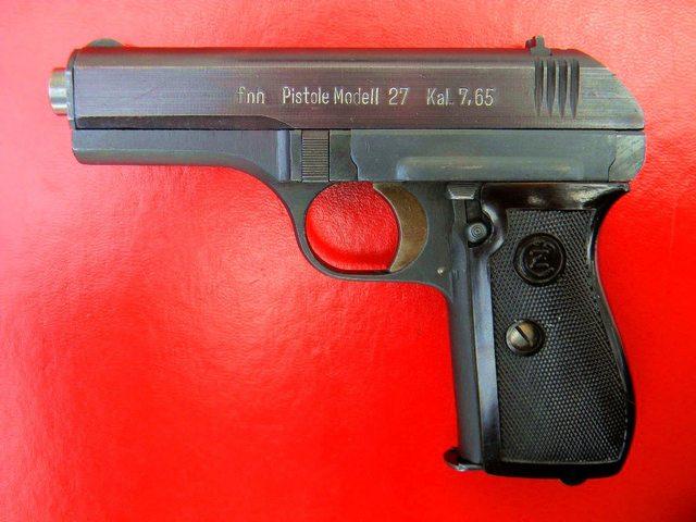

    It's rough but has a very good bore. I assumed it had been refinished due the the plum color of the slide but as another fellow noted the same thing with his and the serial numbers are close, this may be original. I really don't know. Should be parked from what I gathered in research. Serial number check would seem to indicate that this is very late war 1945 but they aren't perfectly clear A second site shows this to be the 44th to last one built under Germanicon occupation 476000 is supposed to be the last. Another 9000 were made from parts post war but no waffens. It has two waffens one on the slide, one on the frame, and only two serial numbers, one on the slide and one on the frame. No other markings I could find. Holster is unmarked and due to pressure/wear spots, not original to this type pistol. It fits perfectly however.
    Asked best price, got it down to $325, offered him $300, he said he had to think about it. Discovered the safety didn't work, could not find a reason for it to not work and he finally countered with $300 out the door.
    Safety was a bit of a pain. I discovered as soon as I got it out to the truck why it wasn't working. It was installed incorrectly. Brought it home, my disassembly book essentially said "do not do that" but I did it anyway and went further than they were willing to go. Put it in correctly and it still didn't work. Was all bent up. Looked for photos on the net, found three other versions before I found this one and I saw where and how it was supposed to be bent and corrected it. Getting it back together was a little hard due to the springs and a tight fit but it now works as it should.
    Assuming the wear and pitting occurred after the war, plum color kind of reminds me of Sovieticon reworks but there are no Soviet marks or import marks on it. I guess it could have gone to Vietnam and been brought back from there but who knows.
    I'm happy, I was going gun stir crazy and this fit the bill very nicely.
    The metal finish work in some places is none-existent. Top of slide has hard grind marks. Barrel has rough lathe marks. Internals actually look pretty good. Dirty but no rust or pitting.
    The side has a little trap door that slides off and exposes the mechanism. I did not ignore the book and only removed the safety bar to reposition it and the safety button bar.

    I have found another fellow who says the plum color is normal. I have yet to find a photo example of one but this guy seems to know what he's talking about. Says it could have been an early war slide that was rejected then but pressed into service late as this one is. The first source I found saying his was plum colored was within a 1000 of this serial number. Seems odd that Bubba would do something to the slide but nothing else. Slide has the same color inside and out also.

    Plum color is normal.

    Good score, and a nice job getting her fixed up. Not a task for the weak of heart. Here's a 1943 production, Parked.

    You guys look like you have museum pieces. Mine has a "good personality".
