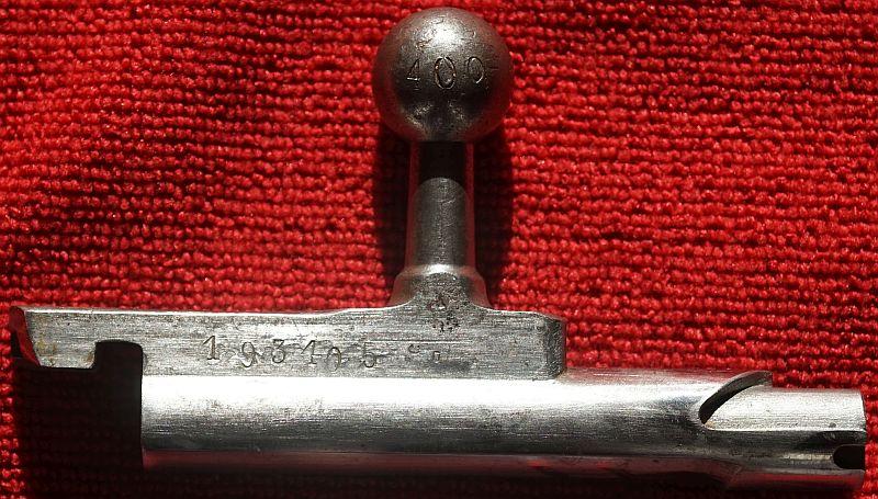

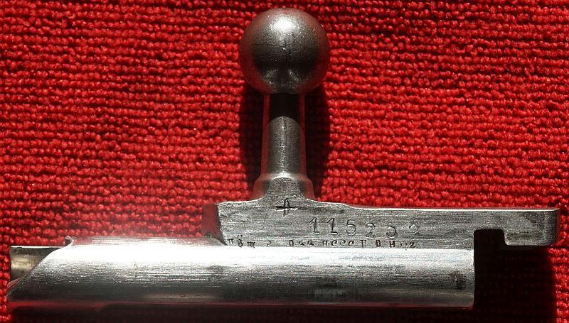

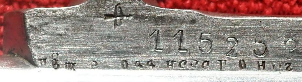

    Please assist me in identifying or at least deciphering the tiny markings along the bolt barrel.

    Well, not quite seriously. I have just looked through 58 pages of Mosin-Nagant markings in "Drei Linien - Die Gewehre Mosin-Nagant" Vol. 2, and apart from the Ishevsk mark (bow and arrow) I am flummoxed.
    It is noticeable that the bolt body has two 6-figure numbers applied. My guess is that the first number was on the left side - the side that is visible when the bolt is closed. For some reason the bolt was renumbered on the right side, and the mysterious extra markings give a clue as to who/what/why/ -- where seems to be Ishevsk. And why on earth is 400 marked on the knob of the bolt handle?
    The mystery markings on the right side appear to read P8m ? 044 NSSS G 0 N ? z. More of a code than a text. NSSS could be the abbreviation for some organisation.
    If this is from a complete rifle, it would be interesting to know if either of the two numbers matches the barrel and/or receiver.
