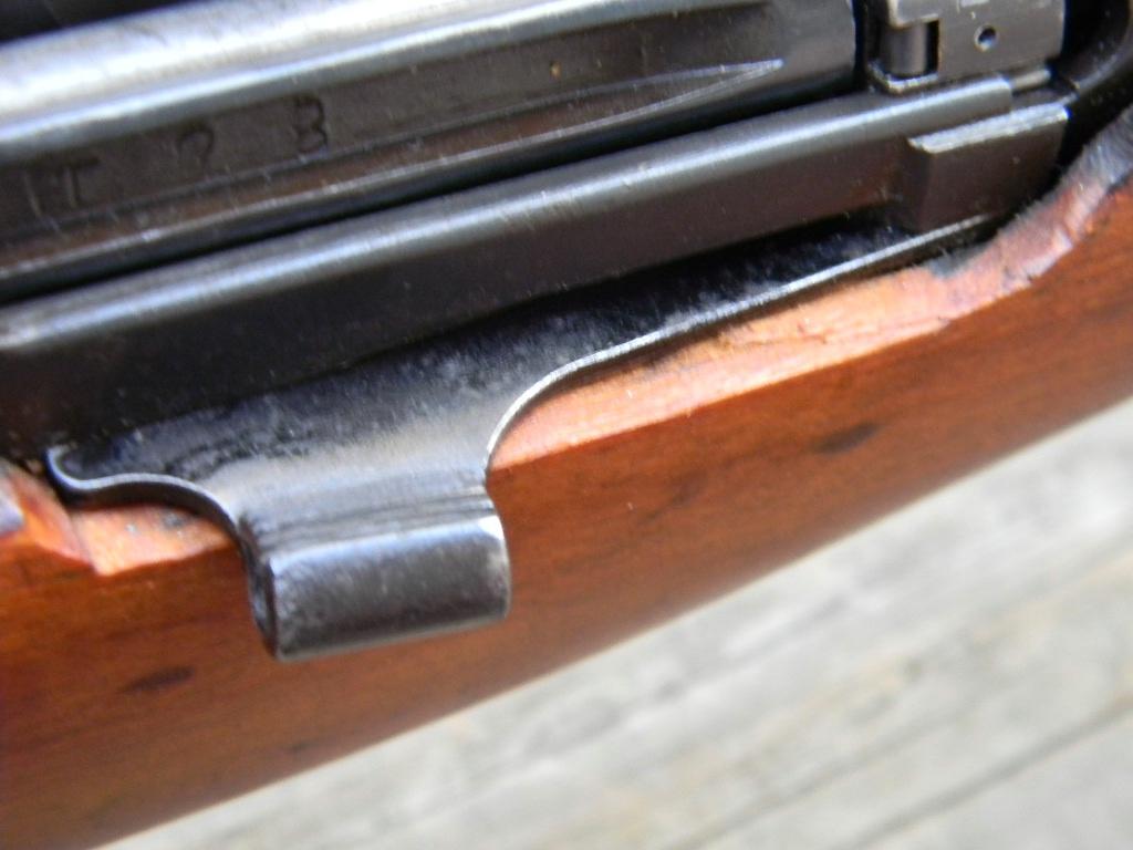

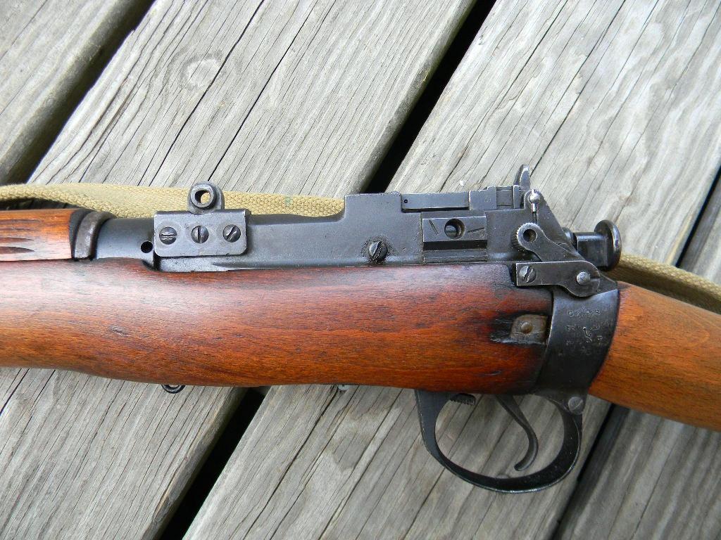

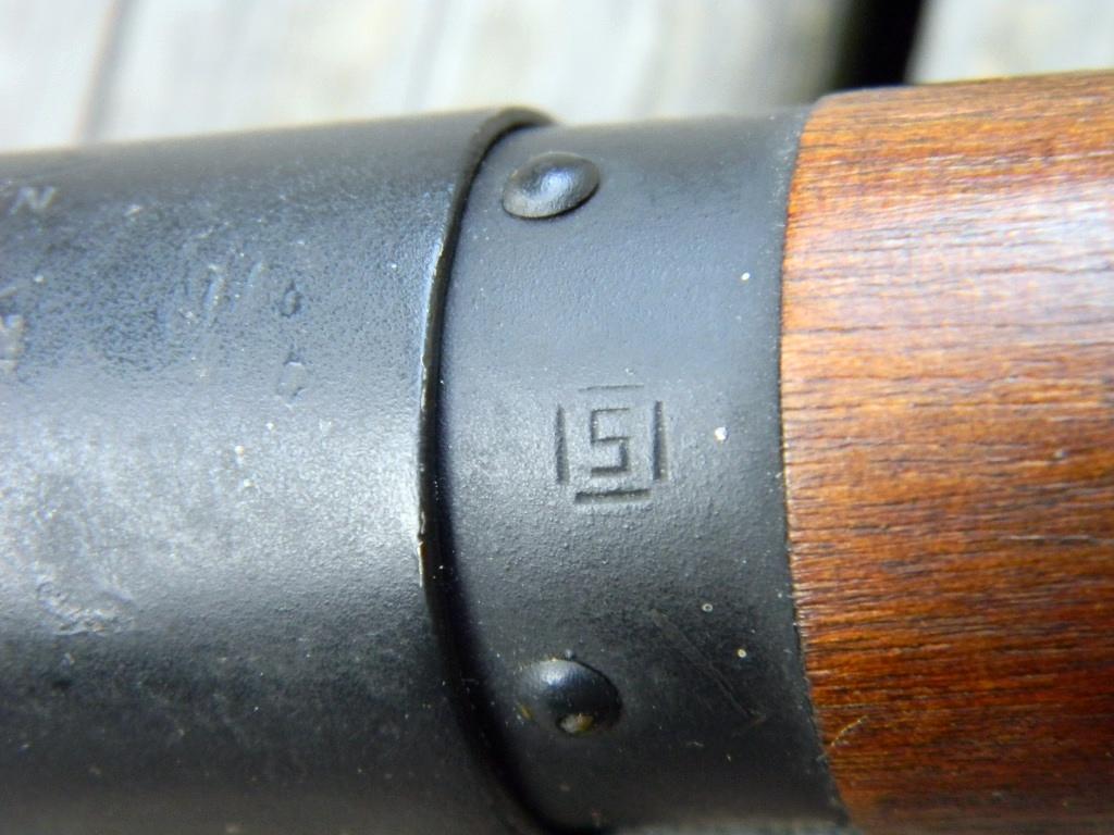

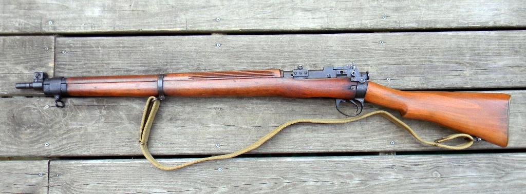

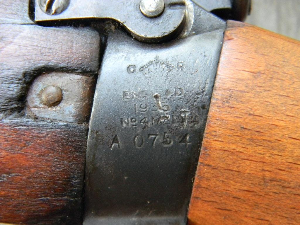

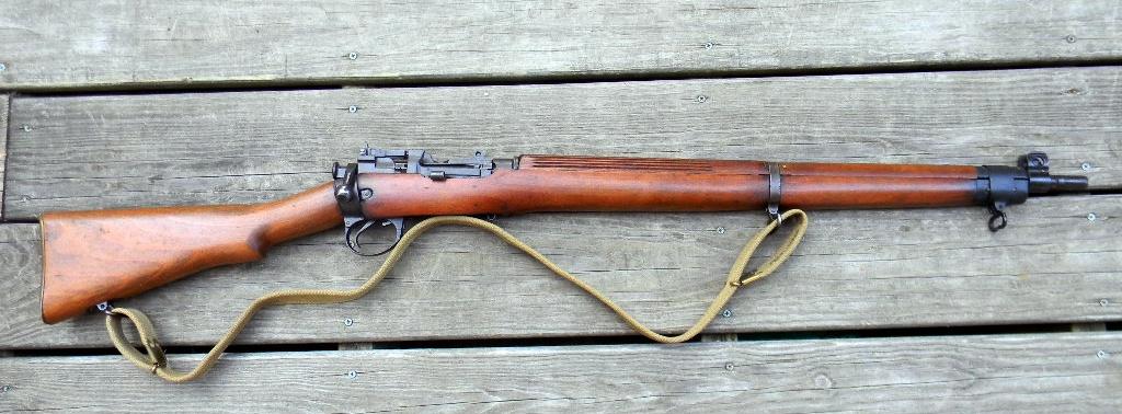

    I have one which was converted to sniper, then de-snipered but the scope pads remain intact. What is an approximate value for that, please? Thanks.
    Edit to add: Here is a link to the pictures.
    https://www.milsurps.com/showthread.php?t=53917

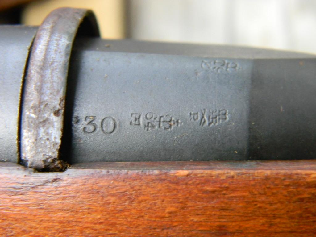

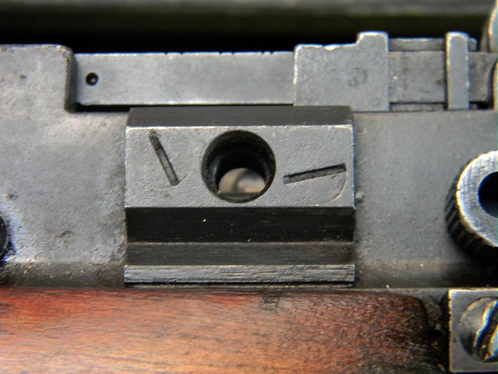

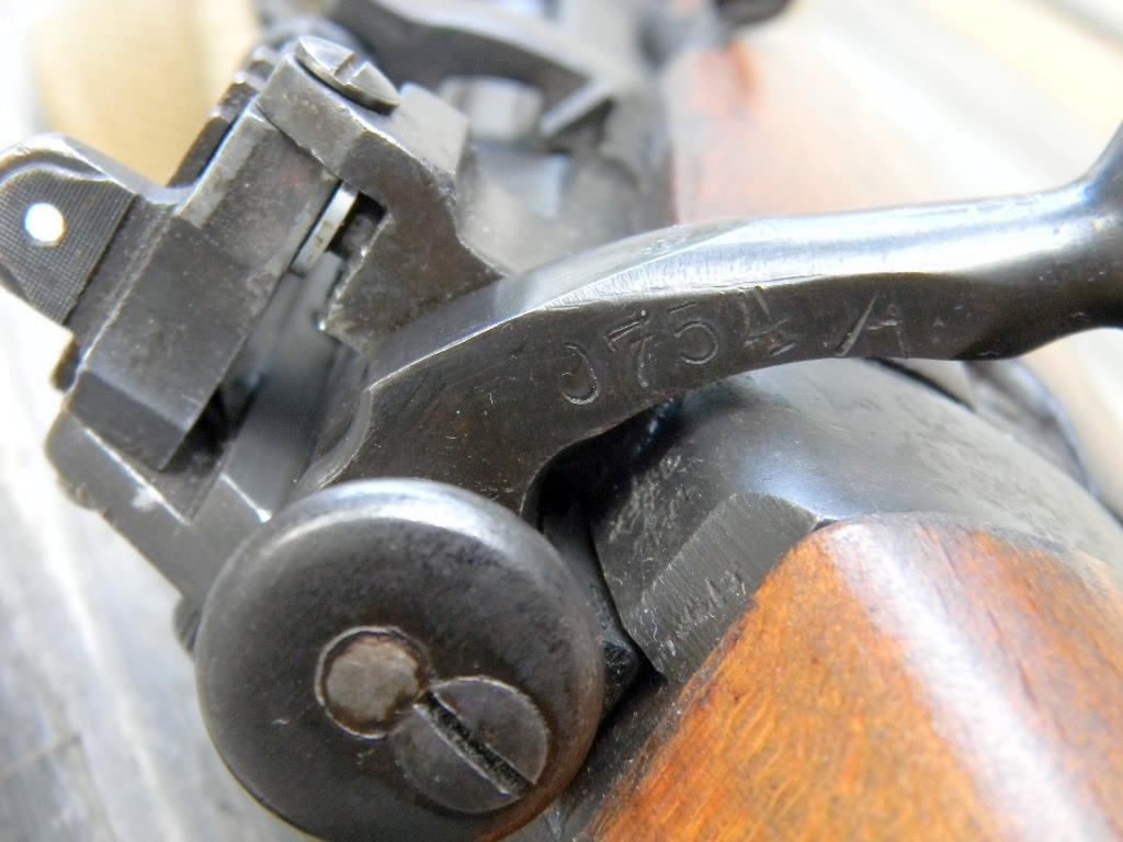

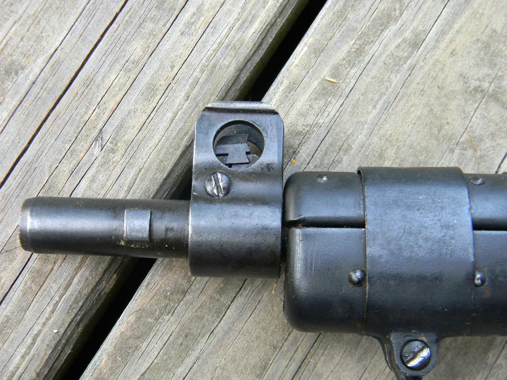

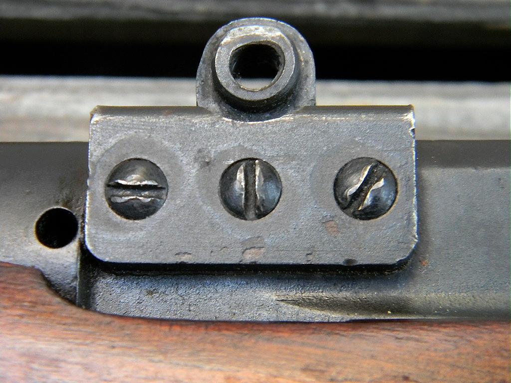

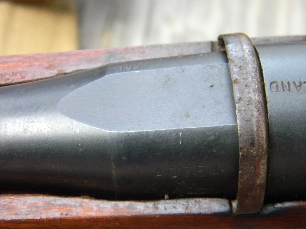

    10:21 AM
    I found my pics in archives.
    I see no option to edit my original post from 2015, so I will add a few pictures here. Any ideas on recent value would be appreciated. Thank you.
