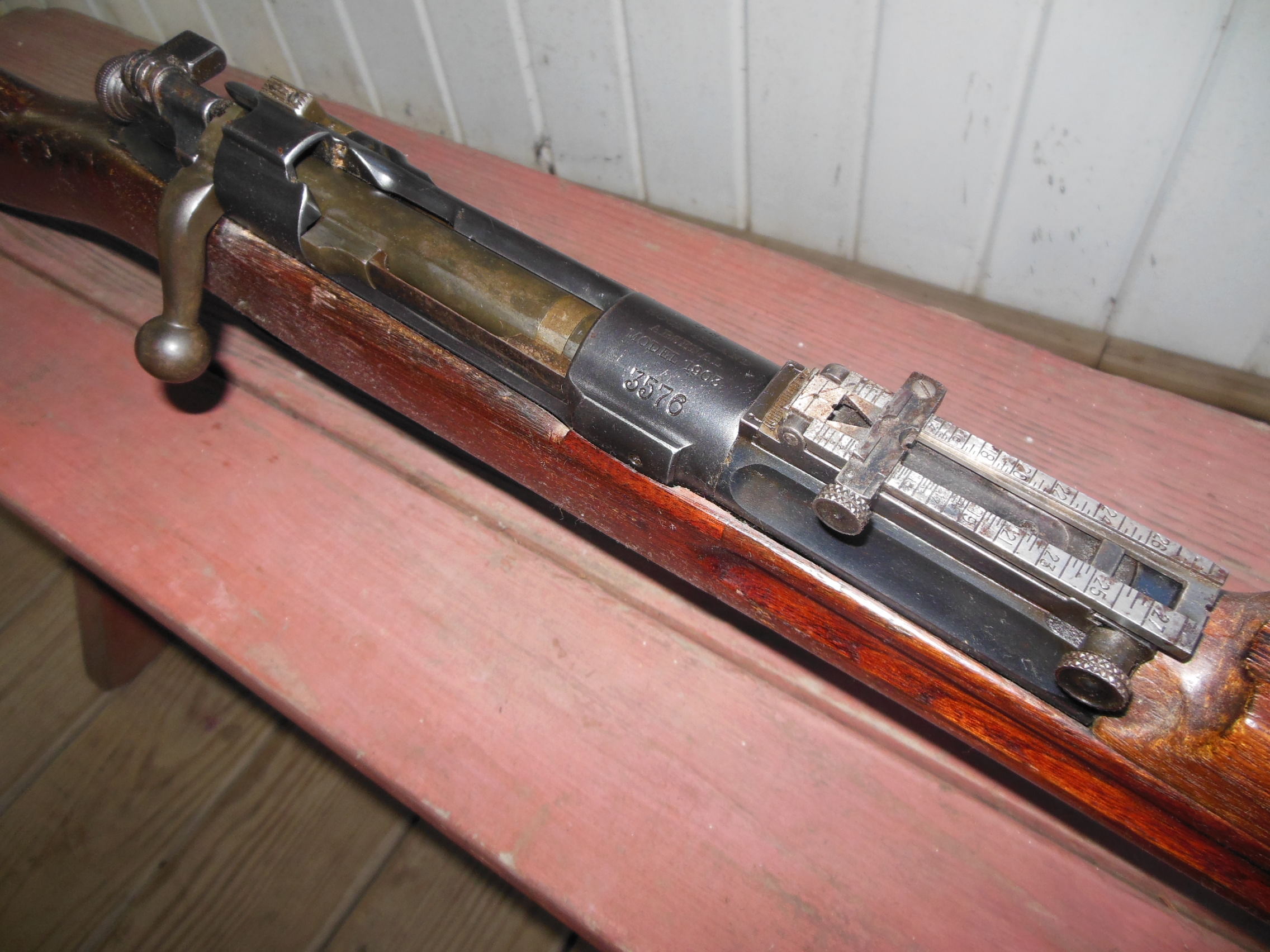

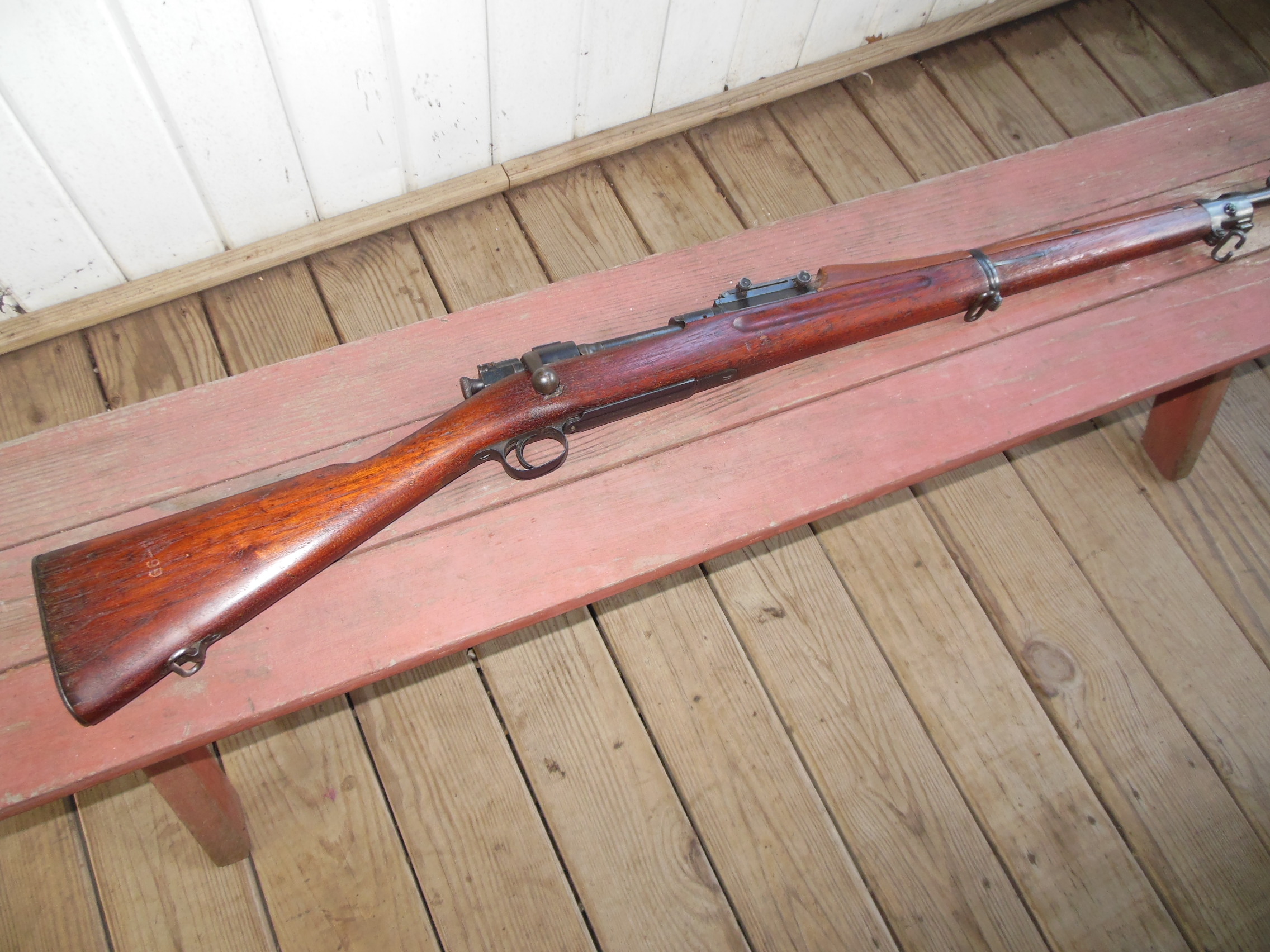

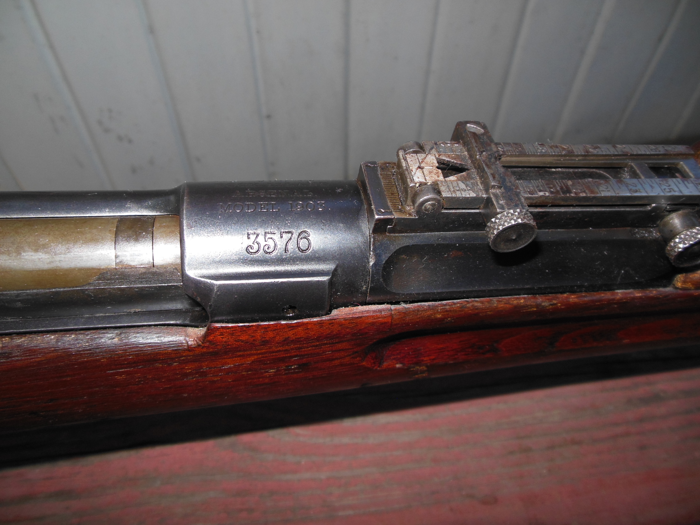

    Back in 2011, I bought an early (s/n 3576) Rock Island 1903 receiver from the CMPicon Auction.
    I was able to restore the receiver to a pre WW1 era rifle with early parts & wood. My question is about the receiver blue color.
    1) Could this blue color receiver be original ?
    2) was this receiver re-finished by the militarty or some group such as the VFW or American Legion ?
    Thanks RCS

    Answers are as follows.
    (1) No.
    (2) Yes.
    Your rifle's receiver was originally issued as part of a 1905 modification rifle in .30-'03 caliber. Sometime between 1907 and 1910, the 1905 modification rifle was returned to Rock Island Arsenal for alteration to .30-'06 caliber. If the receiver exhibited wear from those three years of service, then it was lightly buffed and blued. Your rifle's receiver fits that description.
    Thanks for sharing!
    J.B.

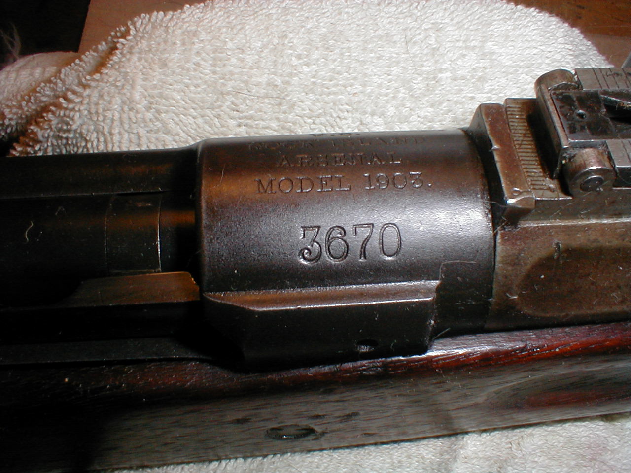

    Back in 2011 when i bought my RIA s/n 3576 receiver, also bought another Rock Island receiver s/n 3670 in about the same condition as the first one plus a blued receiver too.
    I was able to find a SA 6-10 dated barrel and Rick boreckyicon found a single bolt stock for me at the CMPicon North. This stock was an altered 1905 stock plus it had something that I never saw before on a 1903 butt plate, unit markings. Ed Byrns told me the markings are Troop H, 8th Cavalry, Trooper #18

    An original early RIA receiver finish is blotchy.

    original finish
    Rock Island serial number 3576 was refinished as outlined in post #2
    here are two more "blotchy" originals

    They are beautiful rifles — RCS, is the previous upper band hole from its original rod bayonet configuration? I believe the blotchy appearance is due to faded case hardening and oiled rust/patina— same as the Kragicon. When the rifles were rearsenaled/updated prior to WWI the process may have included “browning”/rust bluing some of the case hardened parts and sometime in 1918 the process was changed to parkerization.
